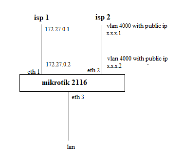

this is the configuration and diagram

is the diagram OK? There are two VLAN4000. Shouldn't it be two different VLANs?
What is x.x.x.2 assigned to? Should it be VLAN4001 for example?

thanks for your comment it shouldn’t be two different vlans.
isp give me that
#vlanid 4000
#subnet x.x.x.0
#pe x.x.x.1
#ce x.x.x.2
#broadcast x.x.x.3
so cidr was /30
that’s why i use x.x.x.2 in my vlan int
