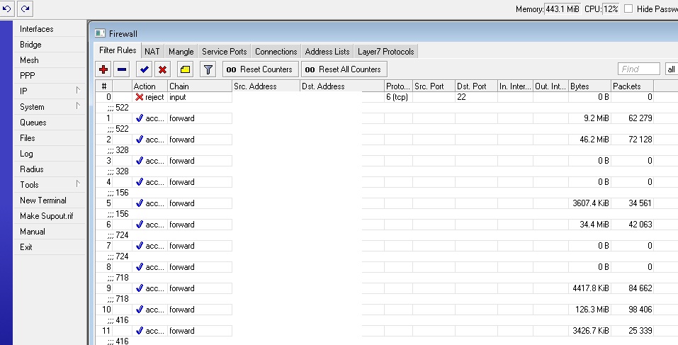

firewall rules are printed out in order they are in, so , you have to get .ID of the first rule in the chain (in the firewall) and use that in place-before. in CLI you can use console numbering, but in API you have to refer to item .id field or to item name.
Thank you for your answer, but I didn’t understand little.
exactly what is .id?
as you see in attached picture .id is the number witch is under #. I understand correct?

usually .id value is star with hex number, here are some examples
*2DA
*2
*A
so when you get results of this command:
/ip/firewall/print
=.proplist=.id
you will get list like this:
=.id=*A
=.id=*B
=.id=*C
janisk
can you send me some example?
it is not clear what example i can give you?
firewall rules are in strict order, so print, and first one will be the correct one, or add some comment to tag the real first rule if you are in doubt.
Commands you use are correct, just values you are placing in are not.
in previous post i gave you examples on how these .id field values looks like - it is star with hex number following that start.
so in short - .id field value you should use to address entries when using API have “*” as a prefix and HEX number afterwards, like *1, *2, *3 .. *A … *F,*10
you can go and use python API example client where you will see clearly, what you send router and what exactly router replies.

I need to remove DROP filter rule from mikrotik, you can see on picture, I made comment “000009”.
I have this script, But I have error…
Can you correct my script and write me exactly script for my situation.
Thank you in Advance..
<? require('routeros_api.class.php'); $API = new routeros_api(); $API->debug = true; include "router_config.php"; \ \ $API->write('/ip/firewall/filter/remove',false); $API->write('=comment=000009'); $READ = $API->read(false); $ARRAY = $API->parse_response($READ); print_r($ARRAY); $API->disconnect(); ?>
$API->write('/ip/firewall/filter/print',false);
$API->write('?comment=000009');
return will print whole entry where comment is as in querry.
if you will use proplist, then you can limit output to just .id field
when you have the .id, you can remove the item
$API->write('=.id=*HEXNUM');
