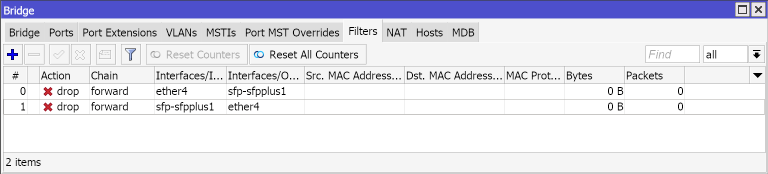

It seems like the Bridge Filters also only work if Hardware Offload is turned off. No Packets are getting recognized if HW is on. If I disable HW on ether4 Packets counting up, and the connection break as expected.
Also on the first look there is no established, related option. Any way to do this?
unfortunately not, no. All static IP-Addresses.
I expect that to depend on the switch model.
That table does remind us that there’s also the option of switch chip rules. This is even lower-level, and some switch chips put a sharp limit on the number of active rules, but it might suffice.
