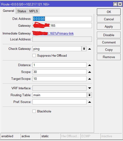

i have seen this response before several times to the question of ARPs appearing on WAN interface and we have followed the advise several times and avoided using interface as GW NHOP. i have attached PIC of how we define the default route.
We select the IP as NH for the default route but still have this ARP lists on WAN. sometimes as many as 4000 entries all with D entry. what could we doing wrong? one thing i find all our clients do with Their mikroitk is they delete all FW rules and leave router open to the internet. their version of securing the router is to change the WIBOX Port and disable all other IP services.. am not sure this really secures the router as FW rules does.
