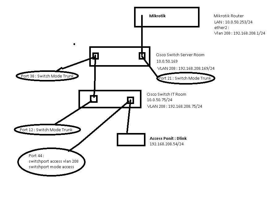

here is the diagram
i just need help ,it fix my issue with mikrotik
and it’s the only ip address i cannot ping but all 192.168.208.0 network can ping each others

I’m a bit confused by the discrepancy between your drawing where the Cisco switch is connected to the Mikrotik using a single cable but with two subnets, 10.0.50.0/24 and 192.168.208.0/24, whereas in the configuration export, these two subnets are attached to two different physical interfaces - 10.0.50.0/24 is attached to LAN (original name ether1) whereas 192.168.208.0/24 is attached to vlan208 which is (in the Cisco vernacular) a subinterface attached to ether2 (original name ether3). What am I missing here? According to the drawing, you should change the underlying interface of vlan208 from ether2 to LAN and you should be good, but maybe the drawing is incomplete instead and you have actually connected ether2 of the Mikrotik to some trunk port on the Cisco using another cable?

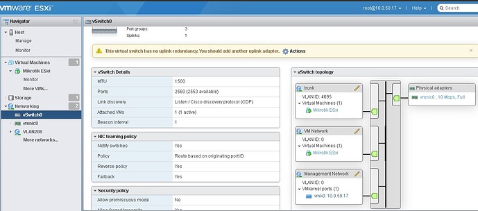

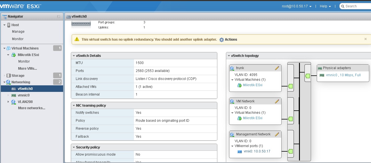

For others brought here by searching for similar issues, the Mikrotik is a virtual one and the virtualization environment strips VLAN tags on reception.
it was the issue with my vmware workstation that have mikrotik on it
and after the help of my friend sindy ,i used Vmware esxi instead and the vlan works perfect with tagged and you have to configure the vlan virtual card on VLAN ID: 4095
here is a screen shot for the configuration
