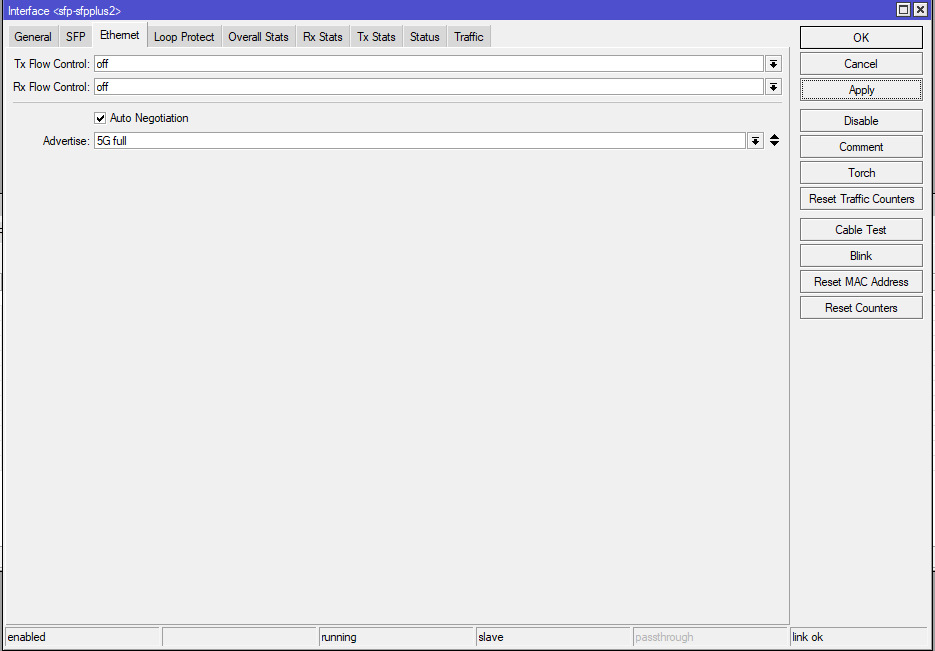

I use two S+ RJ10 (in two CRS310-8G+2S+IN) to perform a stable 5G link over my Cat5e Cables. But as I plug them in, thy perform auto-negotiation with 10G but it fails every second and reconnects. I tried to disable auto-negotiation, but that didn’t work (mybe because of spec). Then I tried to set advertising speeds only up to 5G full. But auto-negotiation also links with 10G unstable. Is there a way to limit to 5G or any other rate?

if I understood you correctly, i’ve tried this already, but the link is negotiated with 10G, no matter what i do in settings. I have screenshots in the attachments.
Both sides the same settings ?
Already tried disabling/enabling the ports after that change ?
Yes i tried this; i also rebootet both devices…
I am confused, that i have 5GFull in my settings, and under “Status” there is advertised from 10m to 10 G.

I already tried without auto-negotiation and set speed to 1G/2.5G and 5G but the switch does always 10G link. I absolutly have no idea why. I tried with two CRS310-8G+2S+IN and also with 1 CRS and one RB5009UG+S+IN.
