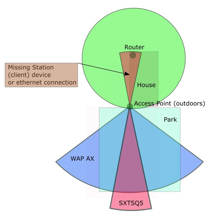

Here is a scheme of how I see your case:

The 20-30 meters from house to park won't likely be a big issue for a directional AP, after all it remains outside and there is free los (line of sight).
No idea what the Eero mesh system is supposed to do or how it can be integrated in your new setup, the points are:
  1. your new AP to cover the park needs to be a directional device but with a not-so-narrow beam, for the reasons already exposed it should IMHO be dual band, 2.4 GHz and 5 GHz [1].
  2. it needs somehow to be connected to your main router/switch, preferrably via an ethernet cable, otherwise you need another wi-fi device set as station/client, better if inside the house, that connects wirelessly to your router (or other AP(s) wi-fi.
  3. the external wall (facing the park of your house) is the bigger obstacle for wi-fi to the park, the "right" approach is putting on it an outdoor AP.
