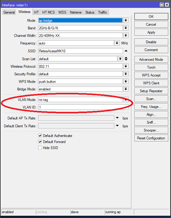

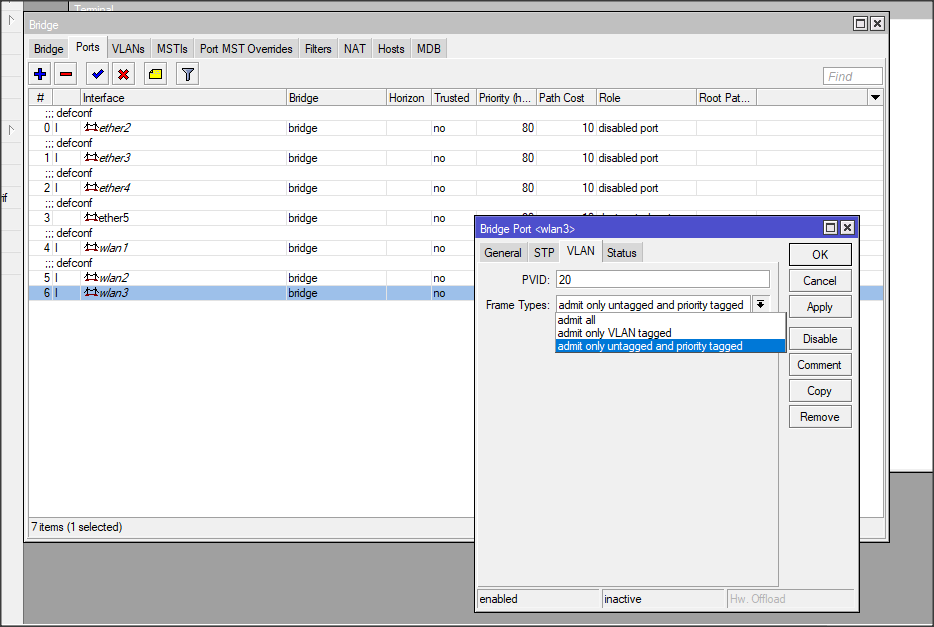

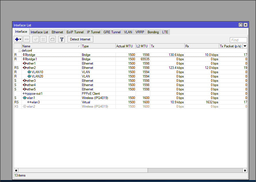

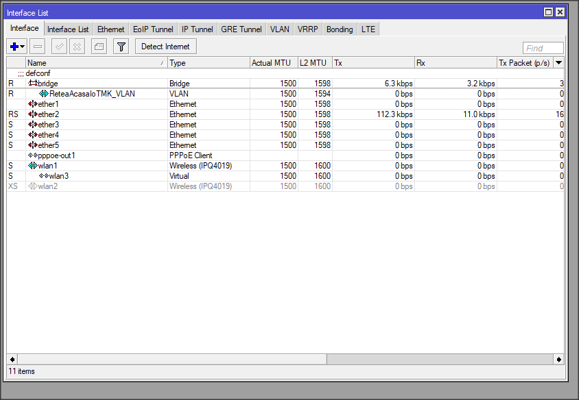

So, please take a look over those 2 pictures.
In one case the VLAN is under bridge and in one case under bridge.
I think that it is impossible to ad WLAN3 on VLAN if the VLANS are under ether2…
It is not clear what the second picture is all about.
If it was me the vlans would be placed under interface = bridge.
if you wanted those vlans running on ether2,
the place to put that is under bridge ports rule.
Ok, good. Clear for me. will delete the second configuration.

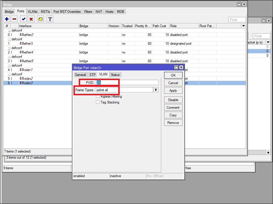

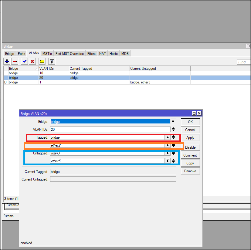

I started from scratch…config without firewall.
It should be ok, right? On the WLANS i don’t get the right IPs…waht can be wrong?
Of course I’m tring now with 2 vlans…

two things stand out… and I can assume that your WLAN2 is not on a vlan (home user wifi)
add bridge=bridge comment=defconf interface=wlan1 admit-frames-only-untagged pvid=10
add bridge=bridge comment=defconf interface=wlan2
add bridge=bridge interface=wlan3 admit-frames-only untagged pvid=20
/interface bridge vlan
add bridge=bridge tagged=ether2 untagged=wlan1 vlan-ids=10
add bridge=bridge tagged=ether2 untagged=wlan3 vlan-ids=20

But…as I told you, I tried the config from this post:
And it seems that on wireless interface he didn’t put any ID…and it was working…

And back again. I solved something:
  • I have the correct VLAN IP on WLAN1 and WLAN3 (vlan10 an vlan20)
  • I have the correct VLAN IP on ether4 &5 (Vlan 10 on ether4 and vlan 20 on ether5)
    The solution was to put bridge on tag…not ether2 :slight_smile: I don’t know if it is a problem with the TP-LINK switch or not. I still dig in.
I still don’t have a solution for trunk port.
=> on wireless interface we don’t need any pvid

It seems that I solved also the trunk port…
Everything is working on tplink switch.
Now, I need to come back to just 1 vlan: vlan10 and default pvid 1 :slight_smile:.
