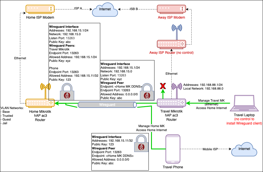

Mikrotik Wireguard Client to Mikrotik Wireguard Server when traveling
I want to take one of my Mikrotik routers with me while travelling and use it as a Wireguard client to allow my devices to connect to broadband at home. I don’t want to install wireguard client directly on my laptop. Ideally, I should be able to connect my Mikrotik router to any random standard ISP router via ethernet cable while I am away. E.g. when I visit my friends, so let’s assume no control over these ISP routers.
There should be no fallback to Away ISP’s internet connection.
My network knowledge is shallow. I have tried approaches from multiple forum posts but need help getting my set up to work.
Currently, whenever I add the following route on my Travel Mikrotik router, I lose access to WebFig and the internet.
/ip route add disabled=no dst-address=0.0.0.0/0 gateway=%wireguard-client routing-table=wireguard-table
[v] Prior to applying the above rule, I am able to ping the Home Mikrotik Router from Away Mikrotik Router.
admin-user@router-ap-back] > ping 192.168.15.1
  SEQ HOST                                     SIZE TTL TIME       STATUS
    0 192.168.15.1                               56  64 1ms276us
[v] Also, the connection from Away Phone works as expected, i.e. I get the Home ISP IP address, and I can manage the Home Mikrotik Router.
Network Diagram in travelling scenario

add disabled=no distance=1 dst-address=192.168.15.0/24 gateway=wireguard-client pref-src="" \
    routing-table=main suppress-hw-offload=no

/routing rule
add action=lookup disabled=no src-address=192.168.88.0/24 table=wireguard-table

My setup when I am at home
At home, I use two hAP ac3 as a router/wireless AP and a wireless AP, respectively. I have 4 VLANs (base, trusted, guest and jail) created based on these posts:
