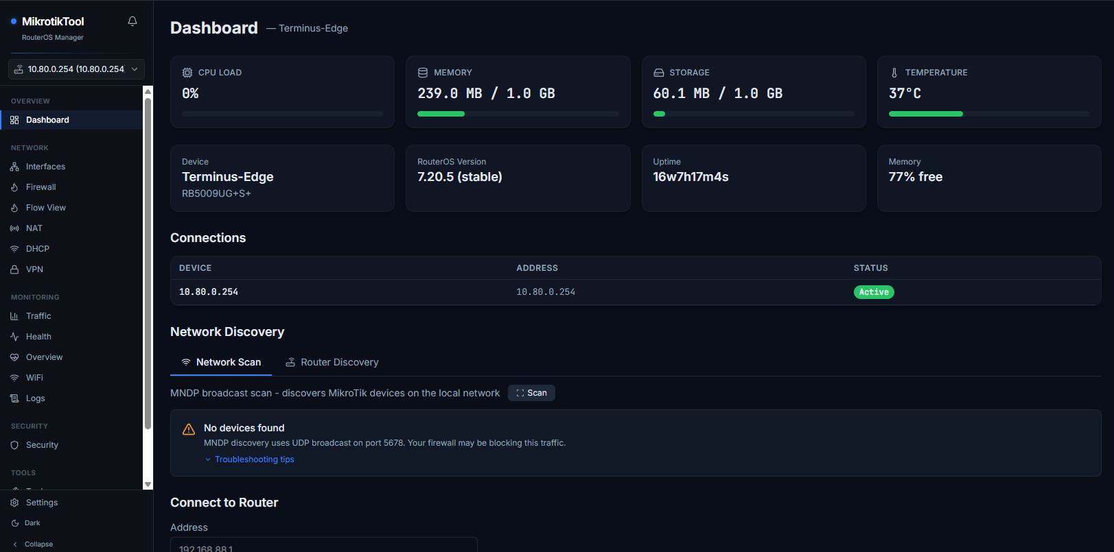

Still very much a work in progress. Here’s what the UI looks like which can be called from the AI chat
