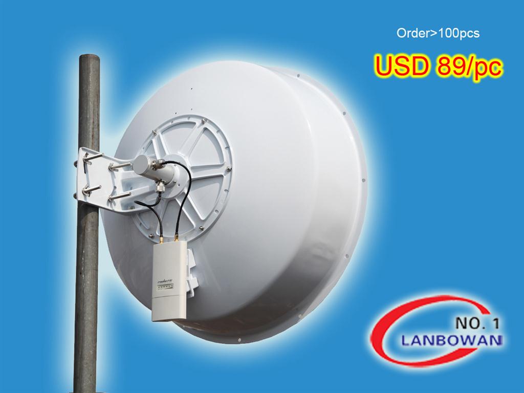

5GHz 30dBi MIMO Dish antenna
http://www.lanbowan.com/ANT4958D30PB-DP.htm
@keraia
Using two grids for this purpose I would expect isolation between each grid and other antannas on a mast will have a effect on the performance
The Lanbowen dish mounting brackett is not well designed and will fail during high winds,
Survival Wind Speed - km/h - 200
  • the dish may survive but the L shaped brackett could be reduced to a V or the L expanded ?
HA. HA, HA…200km wind survival with THIS mounting brackett!!!..GIMME A BREAK MAN!!.. :laughing: :laughing:
Maybe - as I see it - ~ 50km and I say a LOT!!.. :slight_smile:
I would like to see how the test for this was done and for how long or the data spec has a typo = should be 20km/h
