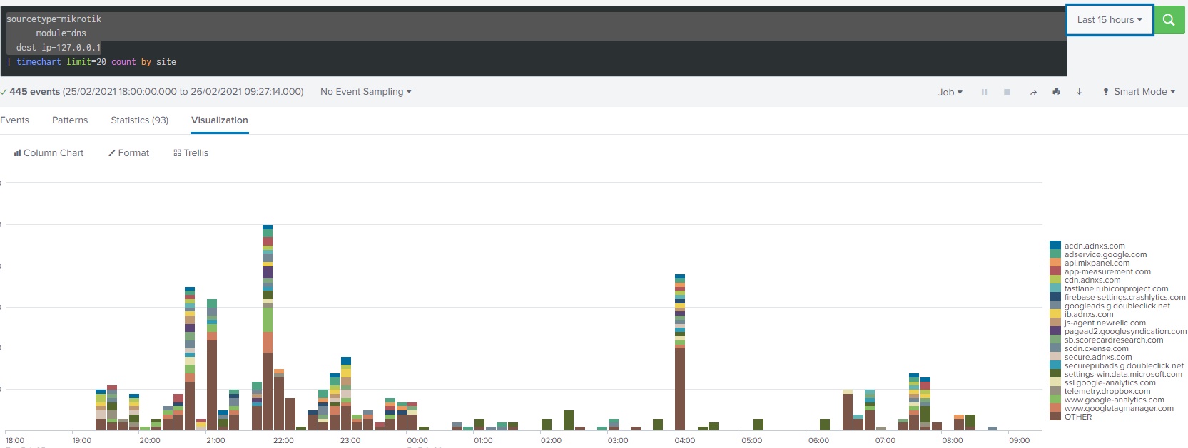

Here is how it looks like after 15 hours of use. 445 blocked access on 124 different sites. (Using Splunk see my signature)
Top blocked site:
site	count
settings-win.data.microsoft.com	44
www.google-analytics.com	22
adservice.google.com	20
googleads.g.doubleclick.net	19
www.googletagmanager.com	19
app-measurement.com	13
sb.scorecardresearch.com	12
acdn.adnxs.com	11
ib.adnxs.com	11
cdn.adnxs.com	10
js-agent.newrelic.com	10
secure.adnxs.com	9
ssl.google-analytics.com	8
telemetry.dropbox.com	8
firebase-settings.crashlytics.com	7
pagead2.googlesyndication.com	7
scdn.cxense.com	7
api.mixpanel.com	6
fastlane.rubiconproject.com	6
securepubads.g.doubleclick.net	6
adx.adform.net	5
api2.branch.io
