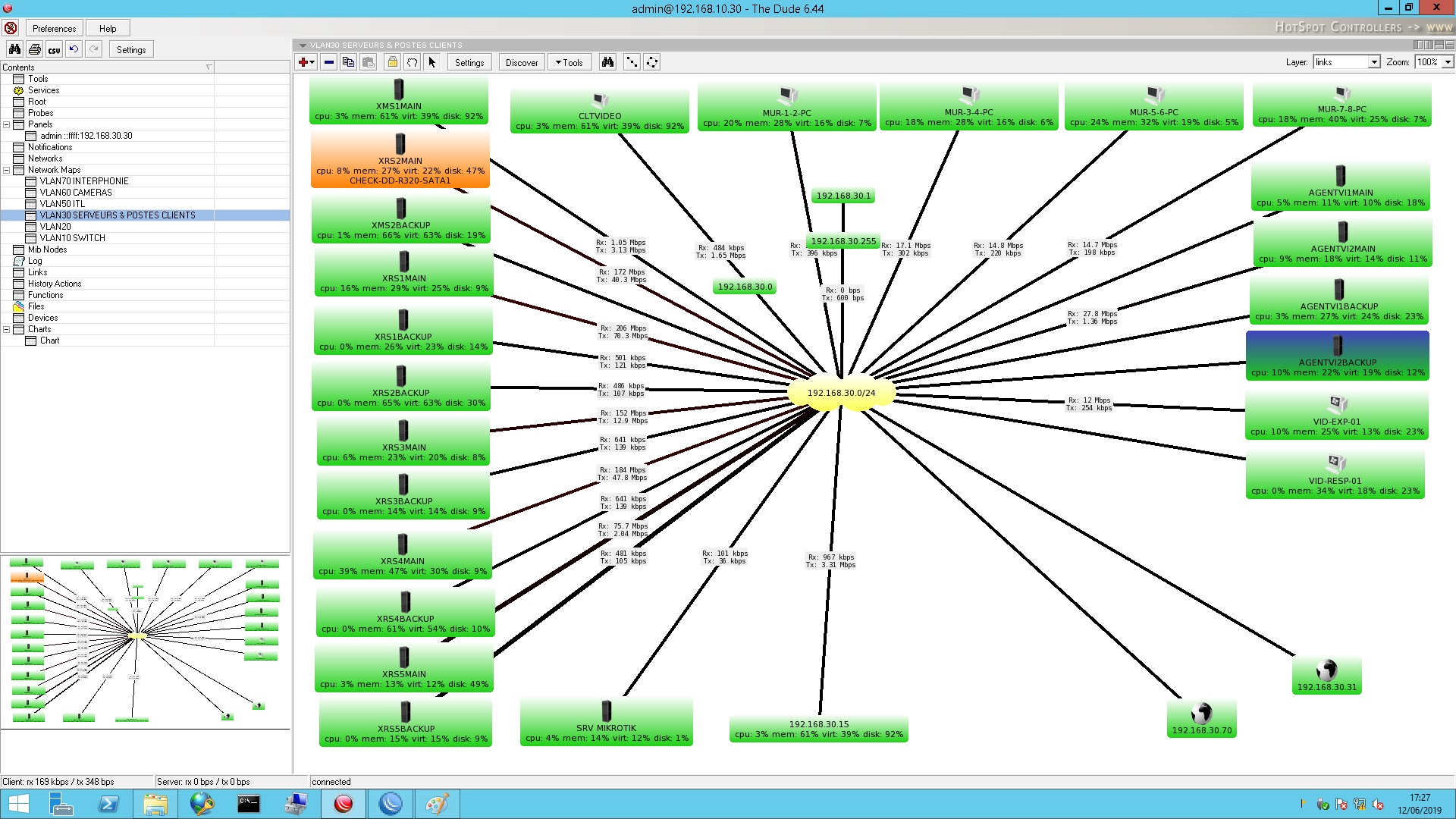

I recently set up monitoring by the dude at one of my clients.

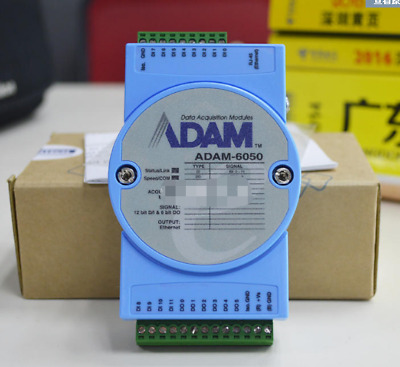

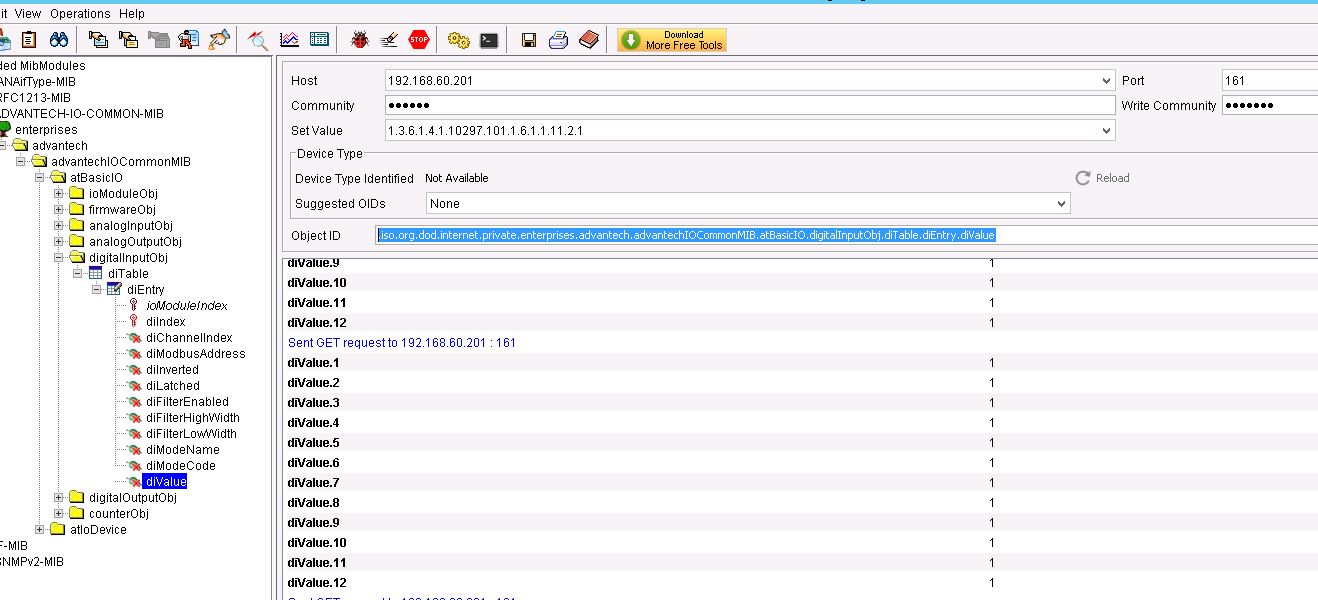

I was able to go all my equipment but I would like to be able to drive a dry contact module in order to switch outputs.
I have the command that can control the outputs but I would like to automate that in case of alarms.

I’m not sure what version of Dude you are running but I run ver 4b3 on Windows Server OS. This version has an “Execute on Server” notification capability, which means that you can write a Windows script to do whatever you want when a probe goes into error. Since 4b3 Dude will only run on Mikrotik RouterOS and the “Execute on Server” notification no longer exists. I have experimented with the “ROS Command” notification in the later versions of Dude, but unfortunately it does not suit my purpose. You may be able to make use of that notification as a way to do what you need. Alternatively, if you have another system that can initiate a script when it receives an email, you may be able to trigger it by having Dude send it an email alert?
