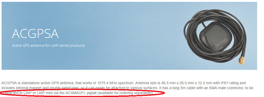

Hi Everyone,
I might be blind, but could someone guide me to install the ACGPSA antenna on a LtAP mini LTE 2024 refresh ?
I’ve figured out to find the connector of the internal, but I would like to install the external one.
I don’t find the correct connector, the size does not seem to be the same.
Should i buy a converter between both connector sizes ?
I didn’t find any tutorial about the GPS external antenna, only the LTE ones,
Thank you,
Specification says:
GPS Built-in MT3337V, with uUFL RF connector and active antenna support
so you need SMA->uFL adapter.
Is this product the right one ?
https://mikrotik.com/product/ACMMCXRPSMA
I don’t know that much those connectors,
Thanks,
That one is MMCX:
https://en.wikipedia.org/wiki/MMCX_connector
The specs BartoszP postred say that the connector is
UFL:
https://en.wikipedia.org/wiki/Hirose_U.FL
You want a UFL to SMA pigtail, not a MMCX to SMA one.
Example, if you want to stay on Mikrotik:
https://mikrotik.com/product/acsmaufl
Thank you a lot,

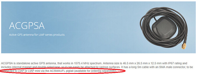

Just read the product page...
