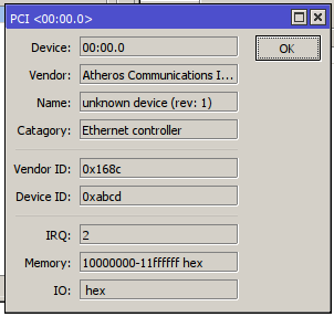

I just received a PCI-E Apple AirPort Express (AR9380 AR5BXB112) card, but ROS is not accepting it.
All I see, under the ROS v.6.5/v5.26, a PCI device 00:00.0 “Atheros Communications Inc.” “unknown device (rev:1)”.
Vendor ID: 0x168c
Device ID: 0xabcd
Are there any tricks involved to get it working on a RB912UAG-5HPnD?

Thanks. I tried that, but there is no changes to be observed out of it.
According to pci ids database that device id “abcd” for that given device is wrong because the BIOS has not been initialized it properly:

I got the same “Apple” card, marked as AR5BXB112, it has AR9388-AL 1A and is detected by ROS as unknown device (rev: 1). My ROS is 6.7.
Anyone has a solution?

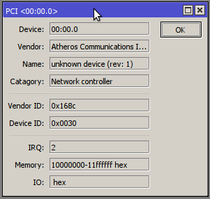

I encounter the same problem, I wonder why yours device ID auto change but mine can’t, the device ID allways is 168C:ABCD after reboot and reboot, the RouterOS can’t detect this hardware. I install the same minipci-e wireless card on another mainboard, this time it was 168C:0030, and work with RouterOS.
So, you had just inserted card to another m-tik board and it was detected correctly? What if you return this card to previous board?
when I return this card to previous board(detect as 168C:ABCD), It will still detect as 168c:ABCD.
BTW, I found when I use this wifi adapter on my notebook coumputer, It was detected as 168C:ABCD with driver version 10.0.0.268 under windows7 x64, windows device manager tells “Qualcomm Atheros AR938X wireless Network Adapter”, but when I change the drivers version to 10.0.0.255, after reboot, Sometimes it was detected as 168C:0030, windows device manager tells “Qualcomm Atheros Ospray wireless Network Adapter”.
I found a solution for this problem: Card is not recognized properly and device-id is 0xabcd
It looks like the problem is with the boot-time, when the card is initialized.
/system routerboard settings set init-delay=2
After that all is OK.
