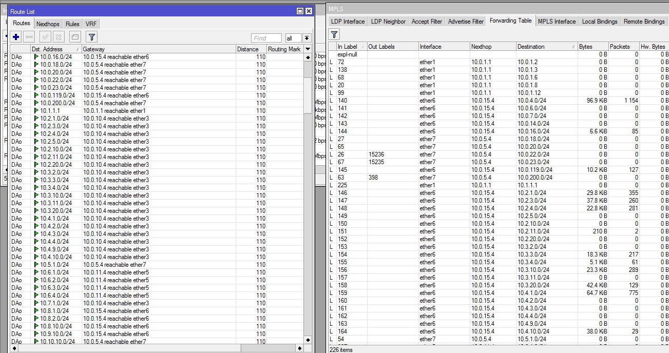

Trying to figure out why this happens after this router reboots. Routes stay proper (it seems) the rest of the time. I have to disable and re-enable MPLS for the routes to “sync” with the IP route/OSPF table in the router to get it back to normal. This is on a 1009 with 6.41 on it

For the life of me I can’t figure out why MPLS routes become different than the same routers IP route list after that router reboots. I have to stop and start MPLS for the MPLS table to get corrected…
I have seen this happen on one router. Could not nail down what is special with this router. Disabling/enabling LDP solved the problem.
It happens every single time the router reboots. And due to a watchdog and other issues on this segment for some reason that seems to happen every day or two. So, each time I have to enable and re-enable for MPLS to function properly. BIG Issue.
