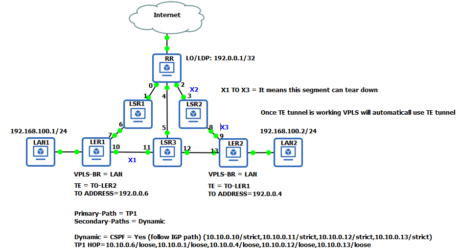

Yes, but the choice of words is not obvious for a non native English speaker I have to read it more than 4 times and count less of hours understanding and troubleshooting the given topology, i’ll attach here to a sample topology that can easily been understood at least from my perspective that might help others in the process, I hope MT can make a sample as easily understood as possible, anyway thanks a ton Maris for your help
