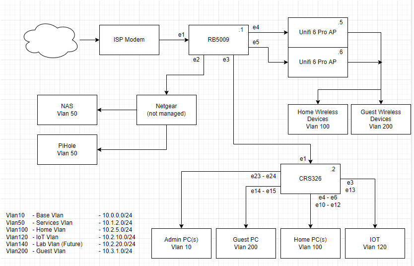

Hi everyone,
I am in the process of kitting out my new house and wanted to take my network up a notch. As I have some previous good experiences with Mikrotik, I purchased an RB5009 to be used as the main router, and a CRS326 to be used as the main switch for the wired connections. For wireless I will be using Ubiqiti Unifi 6 Pro access points, only because I could not find a source for Mikrotik APs.
My main goals are to learn more on networking and configuration of Mikrotiks and at the same time improve the network access for my family, and to boot, improve the security of the whole setup. Please understand that my networking experience is limited to home use.
For the first step I wanted to divide the network into VLANs; Base, Home, IoT, Guest (and when all things are working later on add a Lab). I would also like to run a PiHole as DNS. I had this running on my network in my old house, and was always very happy with it.
I have been trying to configure them both, and after some teething problems, have got it to a decent working state. Largely because of the excellent article from @pcunite, http://forum.mikrotik.com/t/using-routeros-to-vlan-your-network/126489/1 I used most of the configuration mentioned in this article as a base and moved from there to adopt it to my situation.
The RB5009 is handling the DHCP for each VLAN, and is connecting to the CRS326 through ether3. The devices connected to the CRS326 are receiving the IP addresses in the range of the DHCP pool assigned for the correct VLANs. Internet access is working properly. I know the firewall setup needs to be improved, and I still have to add PiHole, nas and network printer. I am focused atm to make the ubiqiti Unfi6 AP work with the setup.
I connected the AP to a port on the CRS that is in the home vlan and used the ubiquiti controller application to adopt the device first on the Home vlan. Next changed the IP address to static 10.0.0.5, DNS 10.0.0.1, netmask 255.255.255.0, and gateway to 10.0.0.1. I added the Home VLAN in the networks section by enabling vlan-only network and setting the vlan-id to 100. Switched the network from default to Home vlan. Subsequently I moved the wire connection from the CRS home vlan port to e4 on the RB5009. The AP boots up, broadcasts the SSID, works as expected. Only after a couple of minutes drops the SSID and becomes non-responsive. Rebooting the AP repeats the cycle. I am suspecting the setup of the Mikrotik to be at fault here as it seems to be working for a couple of minutes.
This is what I would like to ask you help with to debug, as I am a little lost with this atm. Any leads or questions to help get to the bottom is highly appreciated.
Attached the configuration of the RB5009 and CRS326, and a diagram of the envisioned network.
