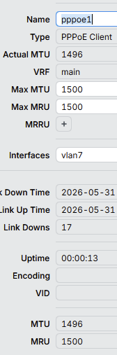

I would like to have MTU 1500 for PPPoE over VLAN.
So to accommodate the pppoe header I set the MTU of the VLAN interface to 1508.

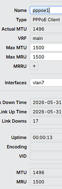

This results in the PPPoE status showing MRU 1500 but MTU increased only to 1496.
I tried setting higher values, also on the physical interface and the max-mtu on pppoe1, but MTU does not go higher.
Is there something else I am missing?
Or has my ISP just configured 4 bytes to low?

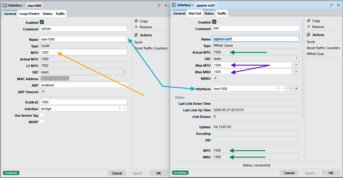

The interface MTU setting is irrelevant for PPPoE traffic as Mikrotiks have separate MTU (for layer 3 / IP) and L2MTU (for layer 2 / ethernet).
Setting max-mru and max-mtu is just a request which would point to the ISP having misconfigured something at their end. You could add logging for pppoe,debug,!packet to observe the link negotiation.

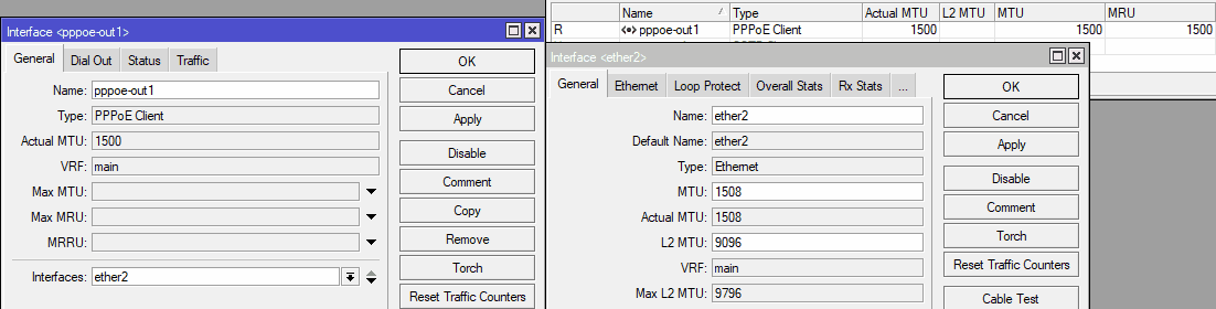

While you are right that the value is irrelevant for the PPPoE traffic itself, it is not irrelevant for auto MRU/MTU negotiation (the client looks at the parent interface before initiating the session to see how high can it go) and it is also not ignored by the client if the value decreases, as seen in the recording above it causes a client reconnect and renegotiation of MTU/MRU.
What you want is to increase the mtu on ether interface tied to your pppoe
Just setting max-mtu and max-mru (all interfaces MTU reset to default) and VLAN on physical interface:
The log does not show anything regarding MTU...

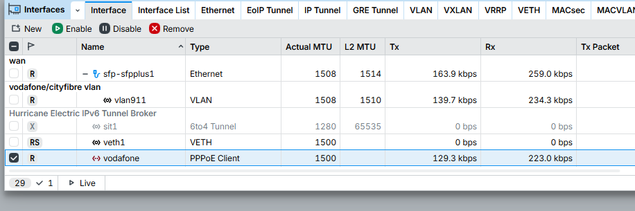

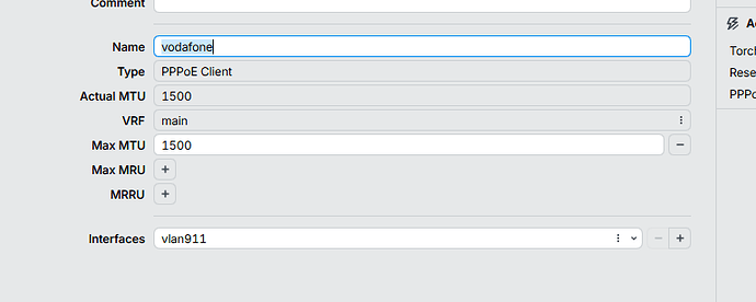

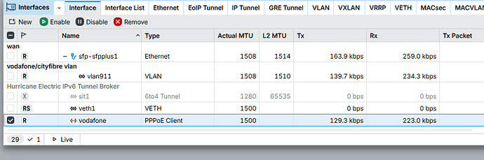

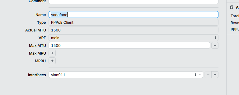

Here is my configuration, Vodafone PPPoE over vlan 911 on sfp-sfpplus1:
sfp-sfpplus1 & vlan911 both manually set to MTU 1508, PPPoE client then automatically connects at 1500.
Sounds like if this doesn't work for you there's something not quite right at the ISP end. The standard is RFC 4638: "baby jumbo frames". Maybe there's anything online from your ISP about this?

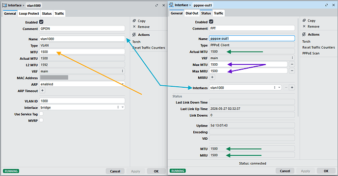

I did complain to support about the behaviour that MikroTik had until RouterOS 7.2 regarding the PPPoE client always trying to negotiate MTU based on L3 MTU of the parent interface -20 MikroTikish bytes in total (8 PPPoE + 12 ???), for standard 1500 L3 MTU the PPPoE client ended up negotiating 1480 MTU.
RouterOS 7.2 Changelog:
*) pppoe - use default MTU of 1492;
this is obviously valid only if parent interface L3 MTU is standard 1500;
If the hardware is made by MikroTik, and the interface has a value for the L2MTU field, then there is no need to increase or modify the MTU value of any underlaying interface. They can all keep the default value of 1500. What you did not do in your screencap, was to do recommended thing and set Max MRU and Max MTU to 1500.
If you do not set those values, they will be inferred from the MTU setting, which makes the MTU of the PPPoE interface depended of the MTU of the layer 2 interface below it. If you've explicitly set the Max MRU and Max MTU value, then the MTU value of the ethernet interface is unimportant. You only have to make sure that L2MTU shows a big enough value (at least 1508 if you want the PPPoE interface to have a MTU/MRU of 1500).
BUT: on CHR/x86 installation where RouterOS is unable to show the L2MTU value of the ethernet interface (value is blank), then you'll need to explicitly increase the MTU value of that ethernet interface (probably so that RouterOS can tell the adapter's driver to increase the frame limit). But on MikroTik hardware, with L2MTU value available, you don't need to make any modification to the MTU of the ethernet interfaces.

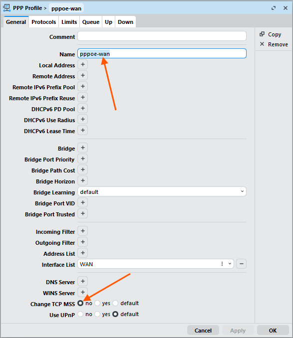

Another BUT: If your PPPoE client uses the default PPP profile, then unfortunately, the TCP MSS of the IPv4 TCP connection will be clamped based on the MTU of the ethernet interface, even if the PPPoE client interface has no problem letting ICMP or UDP packet will the full size (1500 bytes) through, it will clamp MSS of IPv4 TCP connections to only 1452 if you keep the MTU of the Layer 2 interface at 1500.
To not be affected by that, make a separate PPP profile with Change TCP MSS set to No and use that profile for the PPPoE Client connection:
So, to summarize: there is no RFC or standard that recommends blindly hardcoding Max MTU/MRU over the documented auto-negotiation process.
Furthermore, your method of doing so while intentionally ignoring the parent interface MTU actually breaks RouterOS's Change TCP MSS behaviour, forcing users to manually set custom PPP profiles just to prevent incorrect TCP MSS that this approach caused in the first place?

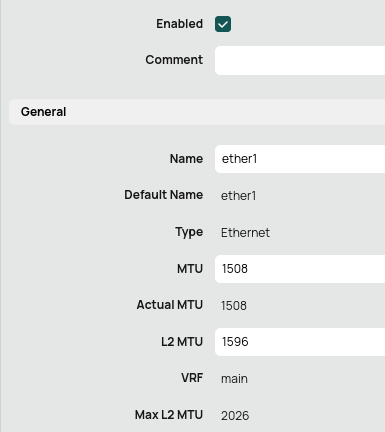

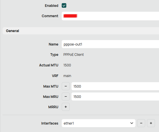

Setting value for Max MRU / Max MTU is according to the standard. If you enable the pppoe logging topic in RouterOS, you'll see that the Max MRU value is used for the ppp-max-payload fields when the router sends out the PADI packets. The Max MTU setting will be combined with what the other side send as their Max MRU, and limits the size of the packets the router send (the limit can be observed when the router send LCP EchoReq messages right after authentication, the payload will be limited by the Max MTU setting minus 8).
If you don't set the two values, then RouterOS uses the MTU of ethernet interface minus 8 for them. You can test by setting the MTU of the ethernet interface to 9000, and keep Max MRU and Max MTU empty. If you enable logging, you'll see the attempt to set ppp-max-payload to 8992. Which will soon be reduced by the value of the other side, because the other side will send a limit much smaller than 8992.
But if you keep the ethernet MTU at 9000, and set Max MRU and Max MTU to 1500 or smaller, you'll see that these setting values are properly used during the negotiation and after the successful authentication.
That is what RFC 4638 dictates: set PPP-Max-Payload during Discovery stage (this depends on Max MRU):
RFC 4638: Accommodating a Maximum Transit Unit/Maximum Receive Unit (MTU/MRU) Greater Than 1492 in the Point-to-Point Protocol over Ethernet (PPPoE) | RFC Editor
And then send EchoReq with the max size to test that the other side can receive the big packet (this depends on Max MTU):
=> Those are the relevant and important setting parameters for PPPoE with RFC 4638 support, NOT the ethernet layer MTU! Setting them explicitly to 1500 is according to the standard.

Thanks guys!
Its a smaller regional ISP - not much to find online...
But RFC4638 seems to be supported, since it increased from 1492 to 1496
Yes, it increased by 4 byte and is still missing 4 byte - could be the vlan tag
