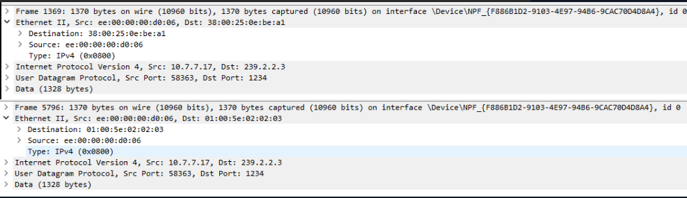

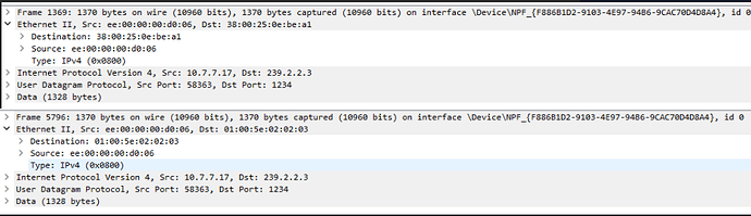

We document the issue by setting up a minimal config on a hAP-AX2, then make IPTV streams available and have clients join the streams wired and wireless, while doing a client side capture.
At the same time we run an RF Tap capture to document the frames are transmitted at the base rate.
The captures show unaltered dst addresses and base rate when multicast-enhance=enabled. This is true for both hardware and virtual APs.
I would love this to be a configuration error on our part, but there is not alot of moving parts. Below is the minimal config and captures provided to support.
mc-enhance.zip (4.1 KB)

So you're saying that even though multicast-enhance is enabled, you still see single frame stream with dst-MAC set to broadcast address ... instead of seeing multiple unicast streams with individual stations' MAC addresses set as dst-MAC?
I wonder if there's a way for AP to detect a sleeping station and thus convert multicasts to unicasts only for that particular station? And if that's the case, this might never happen if all the wireless stations are awake at thime of sending each particular broadcast frame (containing multicast packet).
Yes, dst addresses are not being converted to unicast when using qcom, they are being converted when the legacy wireless package is being used. Thats what the captures below show (01005e prefix pass through on ax2, unicast mac on ac2).

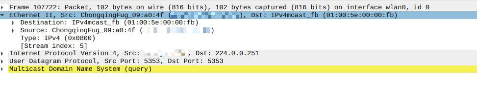

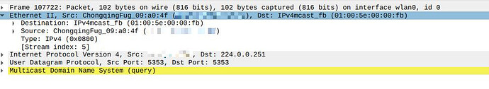

As expected from sniffer: wireshark mdns packet (filter: udp.port eq 5353) destination is "01:00:5E:00:00:FB" (=multicast).

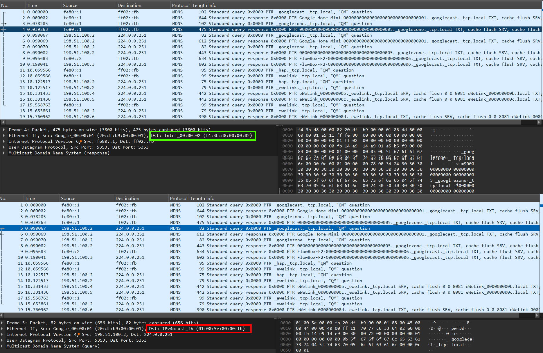

Adding a data point that may help narrow this down: on wifi-qcom the
multicast-enhance conversion appears to be HALF-working — it converts
IPv6 group traffic but not IPv4.
Setup: hAP ax2 (wifi-qcom) as WiFi CAPsMAN controller + AP, RouterOS
7.21.5 (LTS), multicast-enhance=enabled on all AP configurations.
Capture taken client-side (Wireshark/Npcap on a WiFi laptop, managed
mode, filter: udp.port == 5353) while opening the cast device list on
another client to trigger mDNS activity. Several distinct source
devices on the network (Android TV box, smart speaker, IoT, iPhone).
Result, consistent across every frame and every source device:
  • IPv4 mDNS (dst 224.0.0.251): 26/26 frames arrive with
    dst MAC = 01:00:5E:00:00:FB → NOT converted. Matches the earlier
    captures in this thread.
  • IPv6 mDNS (dst ff02::fb): 20/20 frames arrive with
    dst MAC = the receiving station's own unicast MAC, while the
    destination IP remains ff02::fb → genuine L2 multicast-to-unicast
    conversion IS happening for IPv6.
Since the destination IP stays multicast, this is not the mDNS QU-bit
unicast-response mechanism — it's the AP rewriting the L2 destination,
i.e. the m2u machinery exists and runs on wifi-qcom, but only the IPv4
branch is broken. Hopefully that narrows the search for whoever picks
up SUP-180218.
Repro: enable multicast-enhance on a wifi-qcom AP, associate two WiFi
clients, run Wireshark on client A (udp.port == 5353), generate mDNS
from client B or any cast/IoT device, inspect Ethernet dst of incoming
frames: 01:00:5E:00:00:FB / 33:33:xx = not converted; your own NIC
MAC = converted. On my capture IPv6 comes back converted, IPv4 never.
Sanitized capture can not be attached sin I am "new", anyways relevant captures are. (MACs/IPs/hostnames/device IDs anonymized;
multicast dst MACs and the IPv4-vs-IPv6 asymmetry preserved).

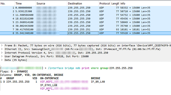

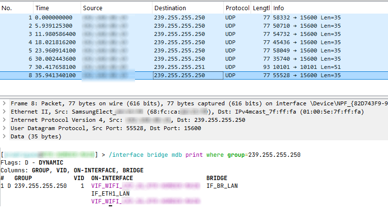

Follow-up on the "224.0.0.x is a special case" point — retested with a
group outside the Local Network Control Block, and it makes no difference.
Test traffic: organic SSDP/SmartThings discovery to 239.255.255.250:15600
(admin-scoped range, regular IGMP-managed group), source on the LAN,
receiver = WiFi client on a wifi-qcom AP (RouterOS 7.21.5, bridge with
igmp-snooping=yes and multicast-querier=yes, multicast-enhance=enabled).
Receiver membership confirmed on BOTH ends before capturing:
Windows client (SSDP service joins this group by default):
>netsh interface ip show joins
Interface 15: WiFi
Scope References Last Address
0 0 No 224.0.0.1
0 4 Yes 224.0.0.251
0 1 Yes 224.0.0.252
0 3 No 239.255.255.250
Router (IGMP snooping learned the group on the client's wifi port):
Result: frames to 239.255.255.250 still arrive at the WiFi client with
dst MAC 01:00:5e:7f:ff:fa — NOT converted to unicast. So the missing
conversion is not a 224.0.0.0/24 special-case artifact: it also affects
a registered, admin-scoped group with IGMP membership confirmed both at
the OS and at the bridge MDB level. Meanwhile IPv6 group traffic on the
same AP does get converted per-station (dst MAC rewritten to each
client's unicast MAC, dst IP still ff02::fb), as posted earlier.
