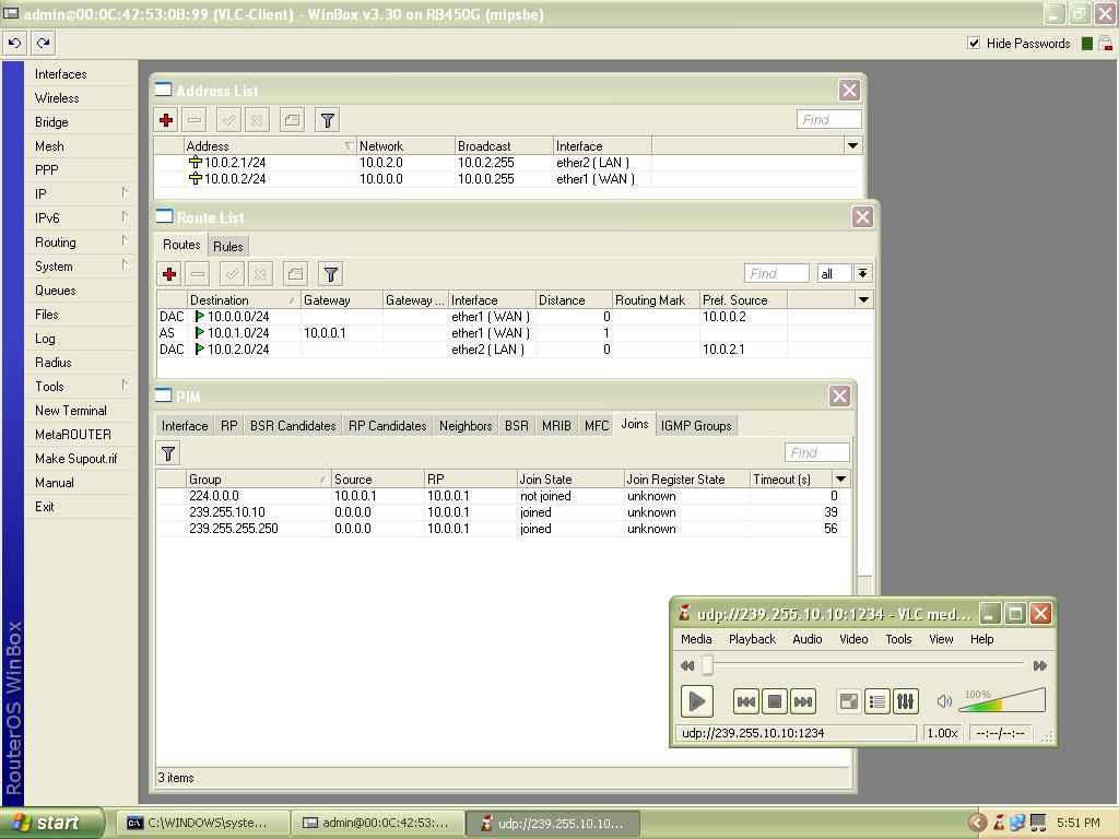

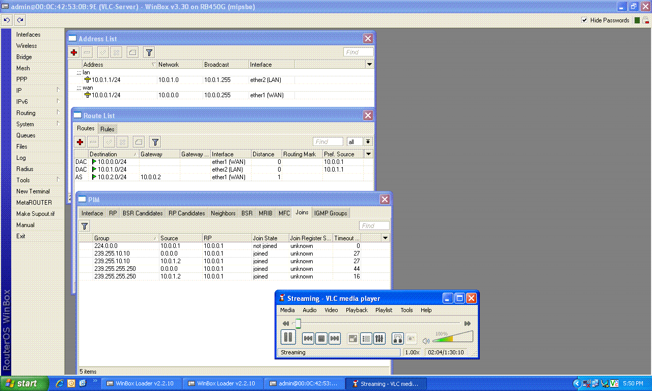

Thanks for reply…
I attached the print screen into my reply while i run video server and try to connect video server from client.
It would be nice for me please see attachment about client joint request and RP receive stream from source.
and your RP is receiving stream data all the time, and when client joins on your other router, then is traffic passed further?
Thanks again ..
Can you told me ? or what can i do for this ?
when client joins on your other router, then is traffic passed further ?

multicast forwarding info is different from routing, you should not add routes at random.
all that matters that network is configured so TCP/IP and ICMP packets can reach from any host to any host in your network, and on that network you build up multicast streaming.
In /routing pim mrib you can check multicast routing information to see if multicast knows where RP is
