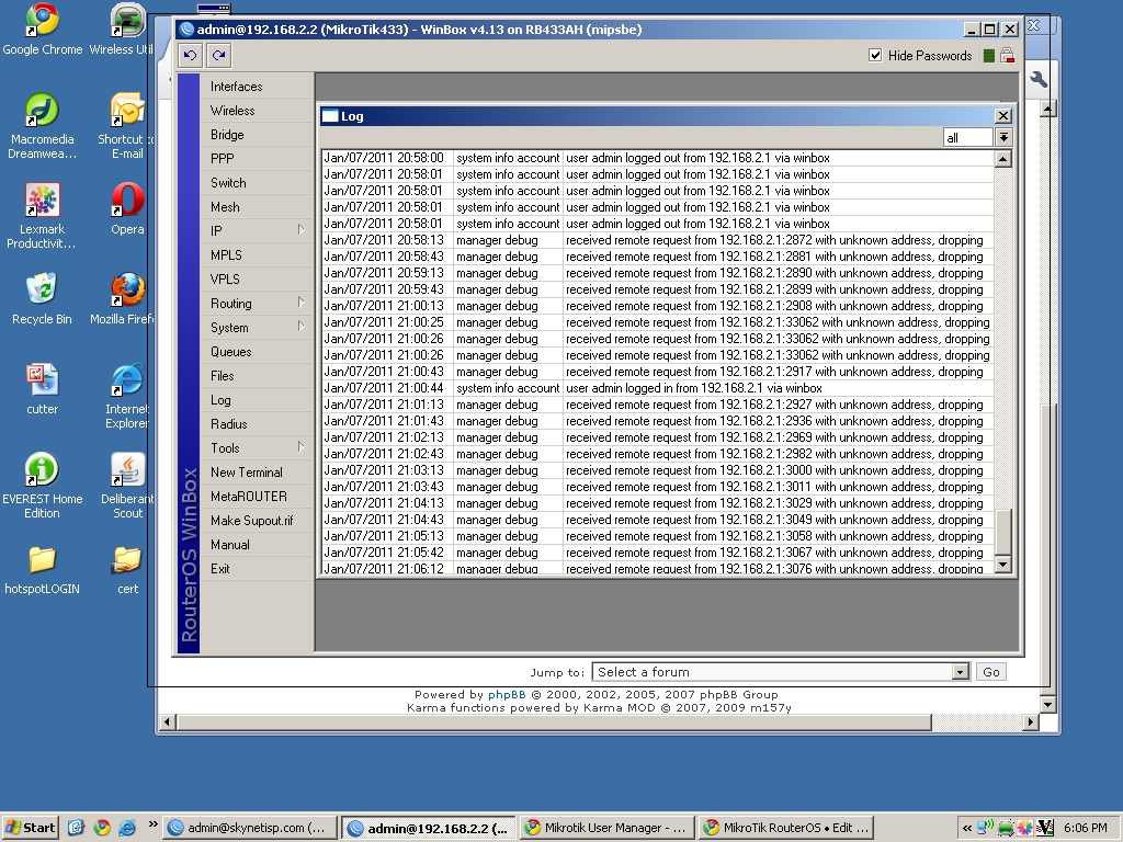

Ok, I did some testing and i doesn’t work. The first thing the user manager does is, checks the source ip of the access request, if the IP is not in any of the subscribers it drops. see screen shot. below.
Any one has other ideas?

Yea, but you can have only unique router ip address in throughout subscribers, so you can not have Hotspot A, in → ex. User Manager ( RADIUS Srv ) Subscribers 1, 2 and Subscriber_3.
It will give you err msg: “The is address already in use”
And it initial access is base on IP and then other options, attributes etc.
