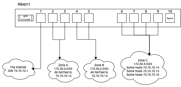

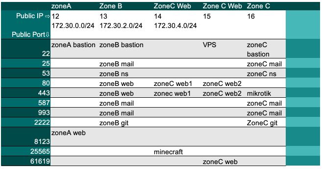

                     Public                Private
          Public IP    Port    Private IP     Port
Zone A    70.70.70.12    22    172.30.0.3       22
                       8123    172.30.0.3     8123
Zone B    70.70.70.13    22    172.30.2.5       22
                         25    172.30.2.30      25
                         53    172.30.2.40      53
                         80    172.30.2.10      80
                        443    172.30.2.10     443
                        587    172.30.2.30     587
                        993    172.30.2.30     993
                       2222    172.30.2.55    2222
Zone C    70.70.70.14    22    172.30.4.4       22
                         25    172.30.4.5       25
                         53    172.30.4.9       53
                        587    172.30.4.5      587
                        993    172.30.4.5      993
                       2222    172.30.4.27    2222
Zone C    70.70.70.15    80    172.30.4.10      80
                        443    172.30.4.10     443
Zone C    70.70.70.16    80    172.30.4.12      80
                        443    172.30.4.12     443
I do plan to have some cross-zone traffic. As a general rule, cross-zone traffic should work like public traffic. That is, if 172.30.0.3 port 22 is available to the public, then it’s available to the 172.30.2.0/24 and 172.30.4.0/24 networks also. All other cross-zone traffic should be denied. If I have to use public IPs and hairpin NAT because that is simplest, that’s fine.

The three zones are basically ZoneA: ordinary users doing wifi and ordinary user things. Just a couple publicly-exposed inbound services. Zone B: a group of systems providing typical internet services (mail, DNS, SSH, git). Zone C: a slightly more complex group of systems. 2 IPs used for load balancing web apps, and the third IP for the core services of mail, DNS, git, etc. Note that none of those things are built out yet. (You can see the one port 8123 in Zone A, but that’s it). I’m still in the planning stages, so you won’t see my attempts at trying to do port forwarding and dst-nat and stuff, because I don’t have the basics working yet.

I attached the full, messy, redacted export. The only thing I took out were static DHCP leases and serial numbers and stuff.
redacted-export.rsc (15.5 KB)
I both edited the original post to be clearer, and I’ve uploaded my full config. Hopefully this makes more sense now.
