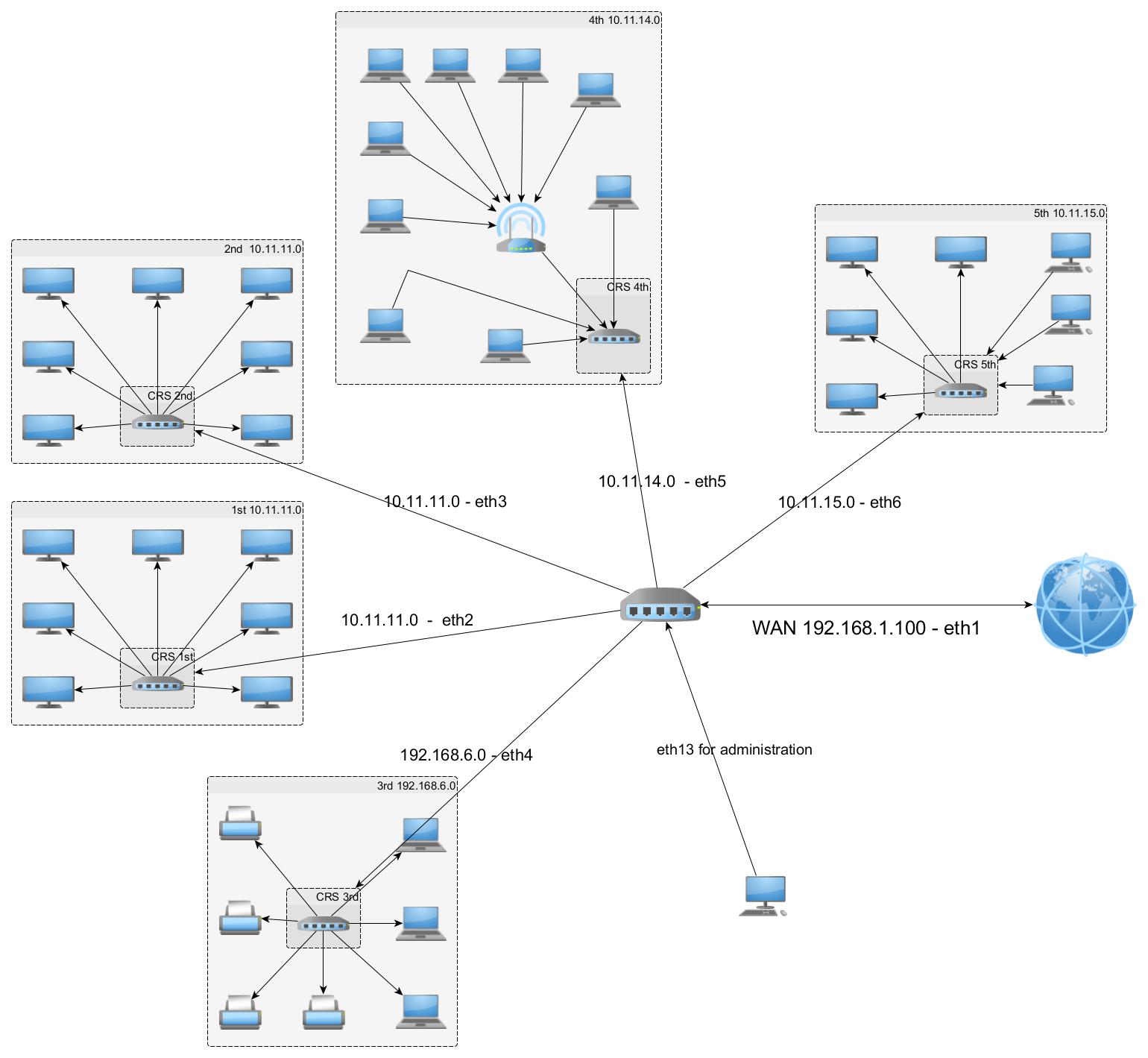

I have following setup.
Main router RB1200 connected on eth1 to the WAN with ip 192.168.1.100, next ethernet ports are bridged [ eth2 and eth3 ] and next ports are separated and has its own dhcp server with different subnet separated from other and connected to the CRS324.
I have done some port forrwarding and I can use winbox to get to the router and each CRS324, on different port, from WAN.
And here is my question, how to configure ie. eth13 to get to the all of CRS’s and the main router with the computer connected at the location?
