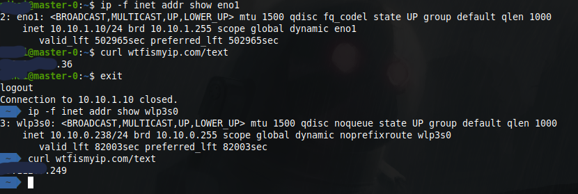

Thank you for the tips. I will start reconfiguring the lan.
Post the config again when you get stuck or have made progress either way.
Thanks anav!
The router now partially works as I thought it should from the beginning. There was only one small issue with the routing rules you suggested, namely I was unable to connect to the router using it’s lan ip. I had to connect through one of the public ips, but I added a rule to send the internal network traffic in the internal network. I’ll be disabling the first rule once I’m done with configuring the servers… I budgeted poorly and I’m out of switch ports on the servers lan and all my other router ports are full except the sfp port, but I don’t have a cage for it at the moment.
/ip route rule
add dst-address=10.10.0.0/23 src-address=10.10.0.0/23 table=main
add disabled=yes dst-address=10.10.1.0/24 src-address=10.10.0.0/24 table=main
Also, when pinging my public ips from my phone’s hotspot ISP1 responds but drops 25% of the packages and ISP2 doesn’t respond at all. I’m guessing it’s the routes and route rules that are interfering… I’ll be investigating why a bit later.
I’ll post my config as well maybe it will help someone else in the future.

What I mean is that devices from my home network should not see the 10.10.1.0/24 subnet and not allow connections from home network lan to servers lan, BUT I want traffic that would go to ISP2 public IP from home lan to not take a detour through the ISP1 to ISP2 link point which is maybe in another city…
Right now with the routes and rules you mentioned my home lan traffic goes out through ISP1 and my servers lan traffic goes out through ISP2 as intened, BUT without the ip route rule add dst-address=10.10.0.0/23 src-address=10.10.0.0/23 table=main, either my home network or my servers network can no longer ping the gateways, and neither can connect to the router config interface using 10.10.0.1 or 10.10.1.1 respectively. To regain access to the router interface I had to use my public ips to connect to winbox.
Okay so its working for the most part.
