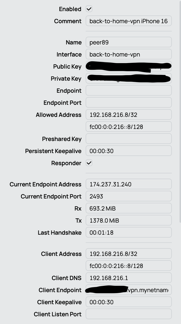

Your command shows that as far as the router is concerned, the only allowed addresses for this connection are:
13  D ;;; back-to-home-vpn iPhone 16 Pro Max
      peer89                           192.168.216.8/32                          back-to-home-vpn
                                       fc00:0:0:216::8/128
Yet, I can access any address/site I want from my phone through the VPN on this peer…So I am confused.

On the RouterOS router, the peer are correct, using /32 for IPv4 and /128 for IPv6, so they will not interfere with other BTH peers, and you can have multiple remote clients connect back to home using BTH (if they have different IP addresses assigned).

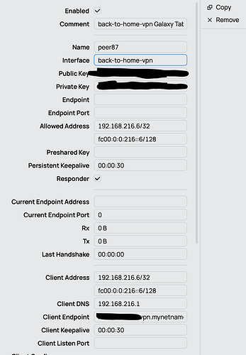

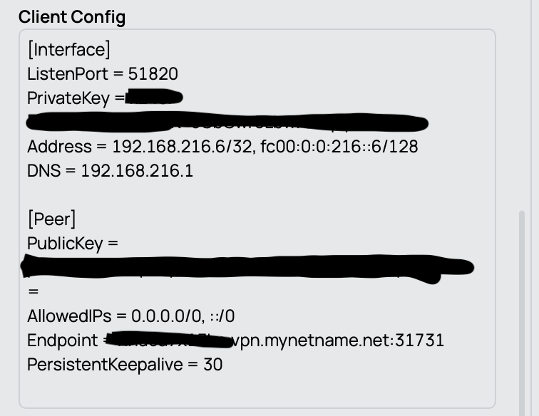

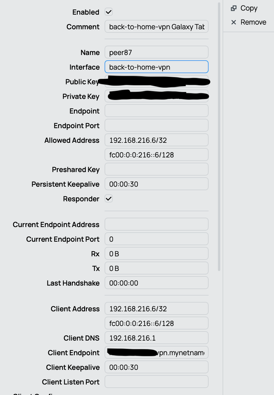

The …. are where I cut lines from the file that aren’t related. So here’s something I just noticed that I’m trying to understand. As you can see, I have an item with the comment “Samsung VPN” and name “Galaxy Tab A9+” - Now, nowhere in the config file is the IP address and peer name of that device which shows up in Winbox:
So the config text looks like:
So is the “interface” the tablet then? Why would it have a “listen” port since it is not listening to anything? And so since the IP address 192.168.216.6 is not stored anywhere in my config file, is the MikroTik getting the address then from the tablet? Does the MikroTik even care to know in advance what the information about the “interface”?
When setting up the config for the router for my kids, do I need to enter both interface and peer information?
I guess I’m just not completely understanding Wireguard…

But if I set up a connection from the MikroTik, what do I need to use for “allowed addresses”? Is that the allowed addresses for incoming packets from the Peer? I want the Peers to be able to access the entire internet through the MikroTik. So obviously, on the Peer side, the addresses need to be 0.0.0.0/0 but what about on the MikroTik side? Is the allowed address only the assigned VPN IP of the remote peer?
This is where I am confused…
OK. So just looked at setting up a dummy connection. If I set up the peer on the MikroTik, no matter what I enter for allowed addresses, the remote peer, always has 0.0.0.0/0 as allowed addresses. So if I want to restrict a remote peer so that it only accesses my LAN over the VPN, I need to set that up in the config on the remote side and NOT on the MIkroTik.
So in my mind then on the MIkroTik side, the only “allowed addresses” for an incoming VPN would be that of the peer on the other side. Yes?

As @lurker888 wrote, with WG the peers are equals. You only choose the router to be "server" because it has a public reachable IP address that accepts incoming connection on the WG UDP port, but inside the tunnel, all the devices are peers.
  • On each device (router, phone, tablet, laptop, etc...), in the [Interface] section you define the peer that is the device itself. You include ListenPort because when the WG app or kernel process runs it need a port to create an UDP socket on the device to send and receive UDP packets. Here you also specify the "Address" which is the IP address in the tunnel that the device choose for itself.
    In your screenshot, BTH generated the client config text file where it put Address = 192.168.216.6/32, fc00:0:0:216::6/128, so when you import that file into the WG app on the tablet, the app will choose the 192.168.216.6 and fc00:0:0:216::6 as its IPv4 and IPv6 address inside this WG tunnel network. When the tablet make a new connection and send things into the tunnel, it will choose either of those IP addresses as source for the IPv4 and IPv6 packets.
  • The config also has one [Peer], that says AllowedIPs = 0.0.0.0/0, ::/0. This is a hint that when this particular tunnel is active, for all IPv4 and IPv6 destinations, this specific peer should be used to send those packets to. And this peer has this specific public key for identification, and if there is no actively running WG tunnel to this peer yet, then the address and port information listed under Endpoint can be used to send the initial WG handshake too. The "yet" here is important. Because WG has support for roaming, while a tunnel between two peers is actively "running" both ends (both peers) can roam and have completely different public IP address. The Endpoint information under this peer section is only needed when the device must make the initial handshake to establish the tunnel. If the tunnel is already established, or if the tablet is not the initiator of the first handshake, then no information is even needed to be listed in this Endpoint section.

If you now edit the tunnel information in the WG app, and change ListenPort to something else for example, then there will be no issue at all, this only affects the port that the WG app on the tablet uses to create the UDP socket.
But if you edit the tunnel and change to Address = 10.20.30.40/32, or Address = 192.168.216.7/32, then there will be problems. Because while the tunnel can be established (handshake only needs the keys to match), the tablet will now send packets with source 10.20.30.40 or 192.168.216.7 respectively, and when they arrive at the router, they will not pass the allowed-address check and will be dropped.
And if you decide to change the PrivateKey under [Interface] on the tablet, then now even the handshake cannot be established, because the new key no longer matches the public key stored on the router for this tablet peer.
Same if on the tablet you edit the [Peer] section and change the PublicKey. If this value doesn't match the value of the router's back-to-home-vpn interface, then handshake will also fail.
And of course, if you edit Endpoint and give wrong address/domain/port, then the table will not be able to initiate the handshake to the router if the tunnel is not already actively running.
Also, please note that in the WG Peer settings on RouterOS, all the fields that start with "Client XXX" are not relevant to the working of the tunnel and the peers. They can actually contain garbage data or stay empty if you wish. But they have a use:
The information from those field will be used to generate the QR-Code as well as the textual config that you see under "Client Config" in WinBox. But it's only to assist you when you want to quickly import and setup the matching tunnel on the external devices. Which means although they can contain garbage, you should keep the value 'in-sync' with the other important values above in the dialog. From the screenshot, you can see "Client Address" (which will be output as the [Interface] -> Address section of the file) should be something that the "Allowed Address" field above in the dialog will be able to match with its listed subnets.
I think this should be /32 if it's meant to be put in the Address = line of the [Interface] section of the WG config.
Unless the "client" is another RouterOS device, then setting the address is done by adding entry to /ip address, then yes, you set the prefix length /24 for the automatically added route. But technically, the assigned address is still only an /32 address.
Of course you are totally correct that it would work the same with a /32 address.
However, wireguard interfaces include additional internal routing (as in distinct from that normally done by the networking stack) and so on-link domains make sense for them. They are different than usual ppp interfaces, as are the interfaces presented by the official OpenVPN and ppp-accel for that matter.
Whether constructing them this way was a good idea or not can be debated, but os vendors have apparently given up and accepted this.

OK. This is all great and I am very close to having an understanding but… I’m still a little bit confused on the allowed addresses thing.
Right now, I am remote and connected to my VPN through my laptop. The Wireguard client on my laptop has the following settings for the connection:
[Interface]
PrivateKey = xxxxxx
ListenPort = 51820
Address = 192.168.216.4/32
DNS = 192.168.216.1
[Peer]
PublicKey =xxxxxx
PresharedKey = xxxxx
AllowedIPs = 192.168.0.0/23, 10.0.0.0/8, 192.168.216.1/32
Endpoint = hhd0a7x17ha.vpn.mynetname.net:31731
PersistentKeepalive = 30
So the interface in this case is the interface on my laptop. Yes? And the Peer - is the peer the laptop or is it the WG? Because if I edit those allowed IPs and say take out the 10.0.0.0/8 entry, I can’t access any of the devices on my 10.0.0.0 network. So the way I am seeing it, this setting on the laptop is important as it says what addresses go through the tunnel to the Peer (in this case the WG). Correct?
But on the WG, the only allowed address I need to have for this connection is 192.168.216.4/32 - Correct? Because that is the only device communicating through this connection.
Am I understanding this correctly?
Yes, with that section in the config file, the WG client on the laptop opens an UDP socket on the port 51820 of all available network adapters and uses the socket to send / receive WG packets (the outer packets of the tunnel).
The [Peer] listed below that is the information about the WG running on the RouterOS router device. Not the information about the laptop's WG. The laptop's WG informations are already under the [Interface] section.
The [Peer] sections of the config file (there can be multiple, not only one) contains information about the other remote side(s) of the tunnel.
And on the RouterOS router it's similar: You define one WG interface (/interface wireguard add), then you add peers to the interface (/interface wireguard peers add). The peer entries added there also contain information about the remote parties (like the tablet or the laptop), not about the router device.
That's how it is intended to work. On the laptop, when the WG tunnel is active, WG will install routes (if running Windows you can run route print in the command line to see them, for Linux run ip route) in the laptop's routing table, by using the information listed by AllowedIPs of all the [Peer] sections of the active WG tunnel. In the example config above, there will be routes installed for destinations 192.168.0.0/23, 10.0.0.0/8, and 192.168.216.1/32, that have the tunnel network adapter (WG creates this virtual network adapter on the laptop when the tunnel is active) as gateway.
Now when you send something with the destination 10.x.y.z and WG is active, the operating system on the laptop will consult its routing table and see that the packet should be sent using the virtual network adapter created by WG. WG which runs behind this adapter will take the packet see the destination 10.x.y.z and scan the peers of the active WG instance. It will find the peer that has 10.0.0.0/8 that can contain this address. It will use the other information listed under that [Peer] section (Endpoint, PublicKey and PreshareKey) to establish the handshake with that remote party (if the handshake is not already active) and then encrypt and encapsulate the packet that needs to be sent (packet with destination 10.x.y.z) and send to that remote endpoint.
As you can see, this look similar to what I described above when the router needed to send the response packet to the remote A9+ tablet, it also had to use the routing table to know that back-to-home-vpn is the gateway interface, and the WG associated with that interface also needs to scan its peer list to find the suitable peer (the tablet).
So now what happens if you remove 10.0.0.0/8 from the AllowedIPs list of that [Peer] section?
  • First, the WG client application will no longer install a route for the destination 10.0.0.0/8 in the laptop's routing table anymore. You can verify this by listing the routes using the command above when the tunnel is actively running.
    Which means when some app/program on the laptop needs to send a packet to destination 10.x.y.z, there is no more route that tells the operating system to use the virtual tunnel network adapter to send the packet. Instead some other matching route, such as the default 0.0.0.0/0 route with some other gateway will be used, and the packet will not be sent using WG.
  • Second, even if you've manually manipulated the routing table and add routes, so that packets with destination 10.x.y.z will have the WG tunnel adapter as gateway, when WG needs to process this packet, it will scan the list of peers to find a suitable one to send the 10.x.y.z destination packet too. But now none of the [Peer] have anything in there AllowedIPs ranges that can contain the 10.x.y.z address. WG cannot find a suitable peer, and the packet cannot be sent.
As a result, you on your laptop cannot access any resources on your 10.0.0.0/8 network.
To be more correct, the start of this question should be "But in the WG configuration on the router...". Yes, on the peer definition associated with the laptop on the router, you only need to list 192.168.216.4/32 because:
  • The router will use this subnet when checking whether it should accept the packets sent by the laptop or not. The laptop will always set 192.168.216.4 as source address of the packets it sends through the tunnel, so this is fine and fully enough.
  • When packets need to be sent to the laptop through the tunnel (including all the response packets to the request that the laptop previously sent), the destination address of the packets will all be 192.168.216.4. So when WG on the router scans the list of peers for a suitable candidate, this peer with allowed-address=192.168.216.4/32 can satisfy the check and will be picked up.
    Of course, if on the router the peer list only has one item, then nothing prevents you to put allowed-address=0.0.0.0/0 for this singular item. And this peer will also be picked when packets need to be sent to 192.168.216.4 and it works too. But if there is more than one peers listed then the peer having allowed-address=0.0.0.0/0 will cause problem, because it might catch all the packets that were intended for the other peers. That's why it's important to not have overlapping address ranges among the peers of the same interface.
And if the WG tunnel is not between the laptop and the RouterOS router (Road Warrior configuration), but between two routers (site-to-site configuration) where you want the LAN behind the two routers to see each other, then having only allowed-address=192.168.216.4/32 will not be enough. Because with that only packet destined to the sole router device can be sent (and received from only that address). If you want to send packets to the LANs behind that router too, then the subnet of those LANs should also be added to the list. This also has the effects that when the devices in those LANs send packets to this side of the tunnel, the packets will have source addresses in those address ranges too, and will be accepted by this side of the tunnel because allowed-address can match those addresses.
