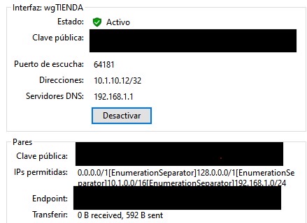

The ip of my WireGuard is: 10.1.20.1/23 (image IP-WG)

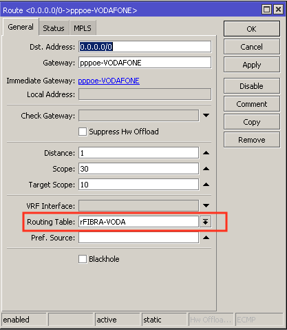

I’ve created a separate table with name “rFIBRA-VODA” with the gateway of the ISP (in my case is pppoe conection) (image route-ISP2)
And create a Routing/rule for move all the traffic of the WG with the ISP2. (image Routing/rules).

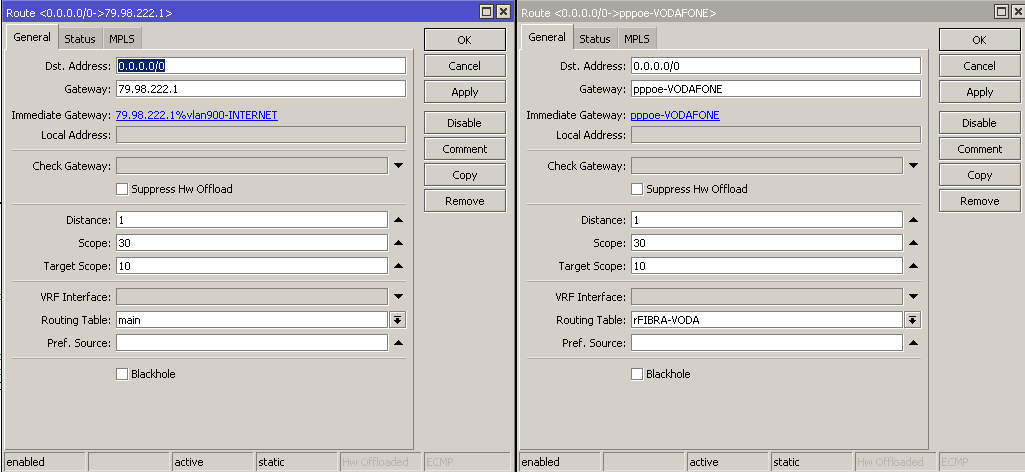

In the image is a diagram how is connected and the 0.0.0.0/0 routes (main [ISP1 route ] and other route [ISP2 route] and image of Main Route (ISP1) and Second Route (ISP2) on mikrotik.

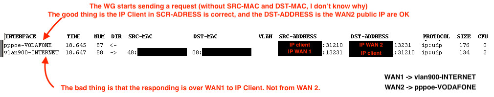

I hazily remember there were some issues in earlier ROS 7 versions with handling Wireguard transport packets by mangle chain output. What ROS version are you running?
In any case, I’d suggest to open a [Terminal] window in Winbox, make it as wide as your screen allows, run /tool sniffer quick port=13231 in it, and make a connection attempt from the client. You should see the incoming request and the outgoing response in the sniff along with the interfaces they go through.
If you can see the request to come in but no response at all, there may be a firewall issue. If you can see the response to leave but via the wrong WAN interface, something is wrong with the routing mark setting.

In the pic of sniffer (i don’t know how to see on terminal for copy the code). There is a request from CLIENT to WAN2, and a reponse from WAN1 to client.

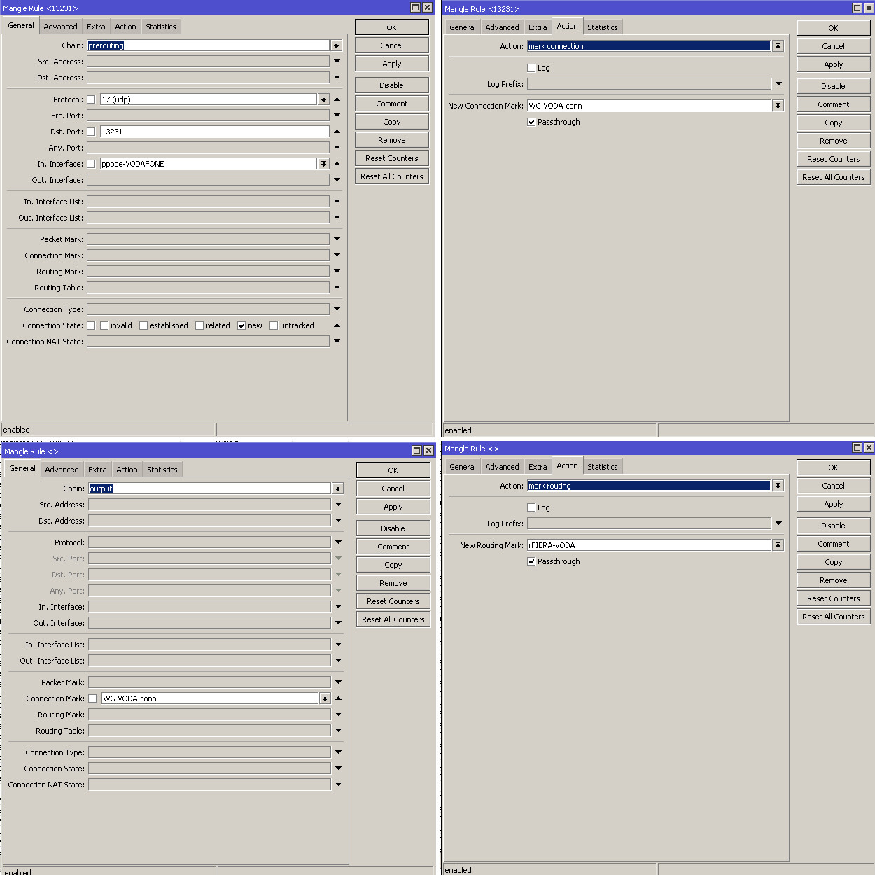

With the “mark connection” and “mark routing” for change the route of a connection that is incomming from WAN2 to reply with WAN2, the “mark routing” with chain “output” didn’t have traffic of packets, but the “mark connection” recives packets when I start the WG from a client with WAN2 configured.
/ip firewall mangle
chain=prerouting action=mark-connection new-connection-mark=WG-VODA-conn connection-state=new protocol=udp in-interface=pppoe-VODAFONE dst-port=13231
chain=output action=mark-routing  new-routing-mark=rFIBRA-VODA  connection-mark=WG-VODA-conn

So there is indeed an issue with assigning the routing-mark. If it was a filter issue, the response would not be there at all. I cannot see whether there is an additional match condition on one of the other tabs, so it may be both a bug or a configuration issue; the export (or a screenshot of every single tab for that rule) would remove this doubt.
So remove (or just disable) the action=mark-routing rule in chain output, and instead add the following routing rule:
/routing/rule/add src-address=ip.of.wan.2 action=lookup table=rFIBRA-VODA
(assuming it will be the only routing rule in your configuration - the mutual order of rules matters so if it is not, they may need to be rearranged).
The solution with connection-mark and its translation to routing-mark in mangle is more generic and can be fine-tuned if necessary; the solution with routing rule is more rudimental but sufficient for this particular scenario. It should either resolve the issue or at least show that there is indeed a bug in handling of outgoing Wireguard transport packets.
