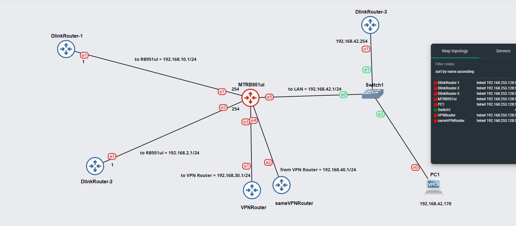

well i want to create a natting rule for some devices inside my LAN -(so this devices have IPs from 192.168.42.1/24 range)- 1- without changing its IPs 2- from a different Router so no congestion or any delay due to alot of traffic from other router that engaged into this network. so for that purpose i introduce this new router that have the IP 192.168.42.254 as i mentioned above.
here is a diagram explain my network:
as you can see i have
3 Dlink router two of them engaged inside MT router.
ether3 interface in MT go to VPN router -(to WAN interface in it)-
ether4 internet came from VPN Router -(from VPN Lan interface)-
ether5 for WAN .
side note : i duplicated the VPN router image for more clarification to show you that i have a link going to VPN router and link came from same VPN router to Mikrotik

so as an update and as l said realier that my WG tunnel is working and i have access to all my devices except the devices that have the Gateway 192.168.42.254 which represent the
Dlink-3 ip address.
Okay I never saw that DLINK hiding in the corner behind the switch LOL. My bad.
To reach the DLINK from the MT it would appear you need an ip route.
lets say the LAN subnet was 10.20.30.1/24 behind the dlink,
Have you tried this on the MT?
dst-address=10.20.30.0/24 gatewy=192.168.42.254 table=main
