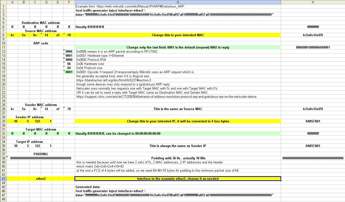

Maybe useful, maybe not, I am attaching a batch script (tested on Windows XP and later) to create the “data” to be sent with Traffic-Generator tool according to:
https://wiki.mikrotik.com/wiki/Manual:IP/ARP#Gratuitous_ARP
It contains some explanation of what the packet is composed of and lists possibly needed on some systems alternative packets (different Target MAC and reply instead of request).
The extension of the file needs to be changed from .txt to .cmd to become executable..
I am also attaching a small spreadsheet in .xls format to the same effect and a screenshot.
GratuitousARP.xls (57 KB)
GARP.txt (3.98 KB)
