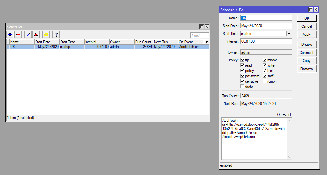

Hello

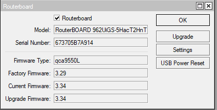

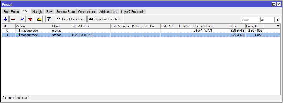

Today i noticed that my home router (RB962UiGS) was hacked. It was running OS version v6.37.1 and current firmware was 3.29.

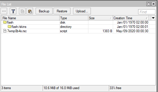

The hacker or who ever it was have created a script that is called “7wmp0b4s.rsc” and scheduled to run at every hour.

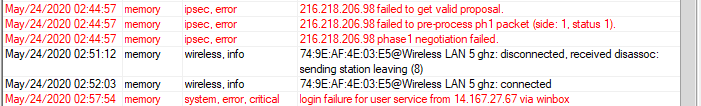

They have established a IPsec tunnel to my gateway and from what i can see in the logs there has been plenty of diffrent login attempts from diffrent IP’s.
How did this happend?
And what can i do to prevent this from ever happening again?
However, keep in mind i had a strong password.
Screenshots below
Defraged

A strong password will not protect you in any way against an exploit. A vulnerability let hackers bypass mostly all security mechanisms. (It’s not just a brute force password attack, its bypassing all checks.)
Only netinstall of your device can save the device. Upgrade/downgrade/reset is at the RouterOS layer, the exploit probably is hidden in the unreachable Linux layer.

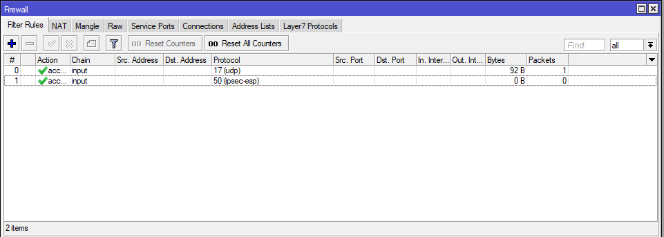

A number of vulnerabilities, including ones allowing to break in without knowing the password, has been fixed since 6.37.1, so this is the most likely reason - along with firewall rules which did not block access to management services from the internet.
A less likely possibility is cross-platform malware, which you might have downloaded to your PC from an infected web page, which has attacked your router from the LAN side, and may even have keylogged the password as you were typing it in.
Now export (not backup) the current configuration into a file, download the file to your PC, and then netinstall the router with the long-term version of RouterOS. Use the default configuration of that version and only modify it with what is really necessary - your saved export will help you with that. Do not import the file with the export as a whole, just use it as an information source.

  • Start with the default firewall, which is blocking access from interfaces in the WAN interface list.
