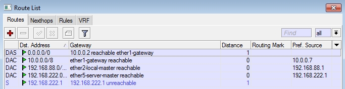

I have one final question, about the route which I added using the following command:
add comment=“” disabled=no distance=1 dst-address=192.168.222.1/32 gateway=
192.168.222.1 scope=30 target-scope=10
If I use winbox, I see the route in BLUE writing, and it says “unreachable” next to it (see attached screengrab). Have I done something wrong? It works, in the sense that my proxy is now working, but it concerns me that it’s blue and unreachable.
Thanks!
Gareth
You cannot have a route to an IP address through itself. Your destination is 192.168.222.1/32 (/32 is CIDR notation for “just this one single IP address”), and you’re trying to reach it through that IP address itself. That is redundant. A destination of 192.168.222.0/24 (that entire network) through 192.168.222.1 (the IP the router has on the interface that entire network is behind) makes sense, but you don’t have to enter such a route: it will automatically be created the moment you put an IP address on an interface as what is called a ‘directly connected’ route.
In your screenshot look at the fourth entry: 192.168.222.0/24 is reachable through ether5-server-master with a preferred source of 192.168.222.1. The route has the properties DAC: dynamic (automatically created when the IP address was added to the interface), active (the interface is up, so the route is valid) and connected (the route doesn’t point to a network behind a transit network, but to a network the router has an IP address on).
So you can remove that blue static route you created and things will still work, that blue static route isn’t used at all as it is right now.
