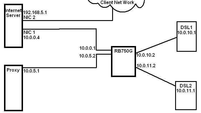

I’m posting this because I have tried every thing I could think of to load balance my internet server between my 2 ADSL routers
I have 2 (4mbps) DSL routers, an internet server, and a proxy server, connected to a RB750G configured to redirect all port 80 traffic from the internet server to the proxy server.
Internet server = 10.0.0.4 gw =10.0.0.1
Proxy server= 10.0.5.1 gw =10.0.5.2
DSL1= 10.0.10.1
DSL2= 10.0.11.1
RB750G = eth1 = 10.0.10.2/24
eth2 = 10.0.11.2/24
eth3 = 10.0.5.2/24
eth5 = 10.0.0.1/24
Now my question is how do I make both DSL connections do the same amount of work?

please make a drawing of your network…
Hope this will give you an idea
then simpliest load balancing will help you :slight_smile:
http://wiki.mikrotik.com/wiki/PCC#Application_Example_-_Load_Balancing
