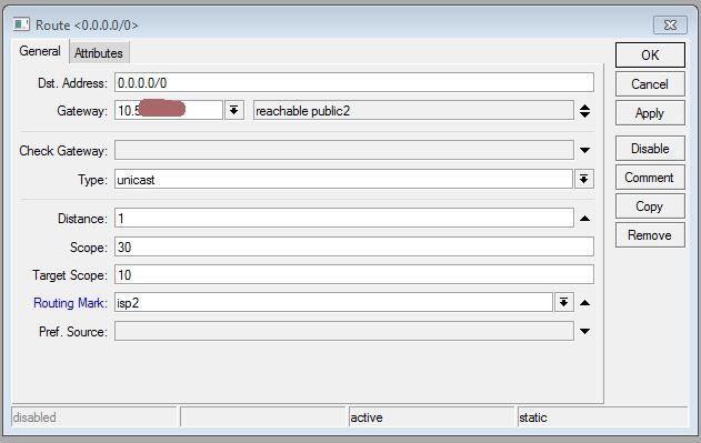

I read above as everything with the routing mark = isp2 goes through this gateway. But I still do not understand where the routing mark is added. There is only one more place in the entire setup where “ISP2” is mentioned and that is in the rule
Does above rule add the routing mark or how is all traffic with src addr 92.168.0.100 placed in the routing table “isp2” and can someone give me a hint as to where in the flow the routing mark is added?

That is exactly my point. The rules are working, so the routing mark must be added somewhere. But when I checked ip/firewall/mangle i could not find any mangle rule adding the “isp2” routing mark - Guaranteed! I made an export of the whole setup to notepad and search for “isp2” and the “isp2” is only mentioned two times in the entire set up and that is in ip/route and ip/route/rule.
So the ip/rute/rule must not only make the lookup, but in fact add the routing mark?
After setting up the wan interface “public 2” These three rules is all what was added and then it works - all traffic from 192.168.0.100 goes through the new internet connection.
add comment=“” disabled=no distance=1 dst-address=0.0.0.0/0 gateway=10.5x.xxx.x routing-mark=isp2 scope=30
target-scope=10
/ip route rule
add action=lookup comment=“” disabled=no dst-address=0.0.0.0/0 src-address=192.168.0.100/32 table=isp2

I just can’t figure out where the routing mark is added that enables to route the traffic from 192.168.0.100 to public2. The only explanation I can find is that the rule
/ip route rule
Does in fact look up all traffic originated from 192.168.0.100 and add the a routing mark = isp2 - or add the traffic from 192.168.0.100 to the routing table “isp2” and the packets are automatcily marked routing-mark=isp2 ???
rgs Pilgrim
/ip route rule
add action=lookup comment="" disabled=no dst-address=0.0.0.0/0 src-address=192.168.0.100/32 table=isp2
add comment="" disabled=no distance=1 dst-address=0.0.0.0/0 gateway=10.5x.xxx.x routing-mark=isp2 scope=30 \
target-scope=10
That’s all that is needed. http://wiki.mikrotik.com/manual//ip/route/rule. Route rules with a type of lookup are the same as marking a packet with a routing mark in mangle. All you can look up by is the destination address, source address, and in-interface, though - but in your case that’s sufficient. It basically says "before routing, look at the rules. This rule says "don’t use the table ‘main’, use the table ‘isp2’. Routes in “/ip route” with a routing-mark are in the table named after the routing mark, and are not in the ‘main’ table. Marking packets with routing marks in mangle basically says “just use the table named after this routing mark for this packet”.
