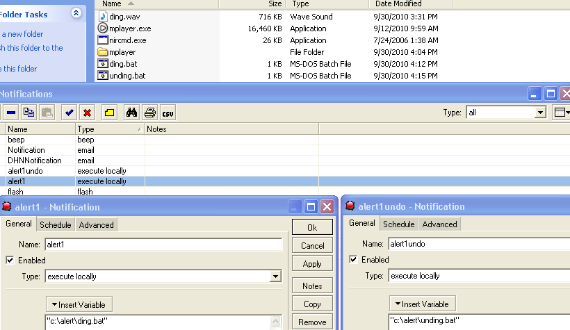

I built two notifications, I had to put the commands into batch jobs and put the commands in quotes. The batch jobs for ding and unding are simple.
contents of ding.bat
c:\alert\mplayer.exe c:\alert\ding.wav -loop 0
contents of unding.bat
c:\alert\nircmd.exe killprocess mplayer.exe
It works.
