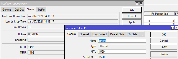

I can not reach the Netflix if i have IPv6 enabled. Or on every 10th try i get netflix to work. I find the solution but i need translatin to Mikrotik talk.

MSS clamping of 1432, or interface MTU of 1508 with PPPoE MTU of 1500 (note that the config tree in Edgerouter tries to set an MTU of 1412 if it’s blank and you make changes to something unrelated)

My isp give me /56 subnet so no VPN is in play here.
My config
https://pastebin.com/7p3gZ3iP
