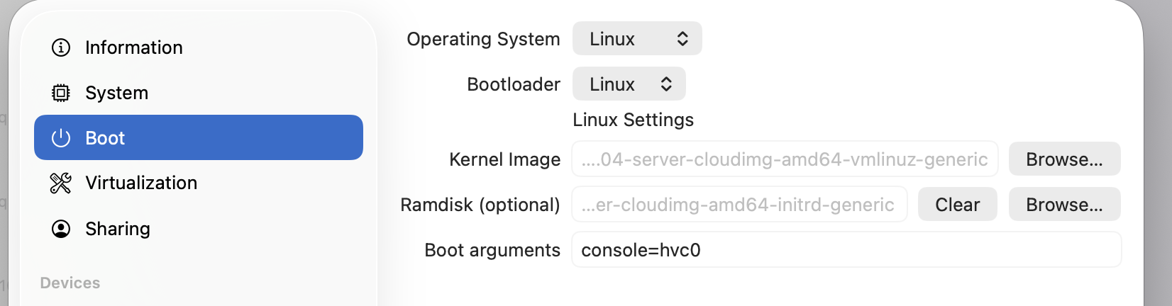

Specifically, I configured just the Linux kernel and initrd/busybox in UTM... so it comes up in seconds. And takes ~50Mb for the needed Linux things to boot, plus whatever netinstall/package take. On Intel, kernel used is ubuntu-21.04-server-cloudimg-amd64-vmlinuz-generic and ubuntu-21.04-server-cloudimg-amd64-initrd-generic.
And for Apple Silicon, likely do same, but with ubuntu-*-cloudimg-arm64-* images from:
https://cloud-images.ubuntu.com/releases/hirsute/release/unpacked/
"vmlinuz" is the "Kernel Image" and "Ramdisk (Optional)" is the "initrd".
See https://developer.apple.com/documentation/virtualization/creating-and-running-a-linux-virtual-machine#Obtain-the-Kernel-and-RAM-Disk-Images which linked to Ubuntu 21.

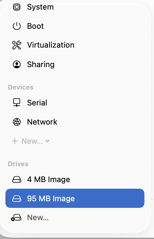

With the boot arg console=hvc0 being needed, since there is no "display", only serial. So need also remove the "Display" from UTM, and add an 2nd Disk in UTM (I used Apple Sparse mode, so even the RW package repo disk is compressed, see 95MB (which Linux thinks is 1GB).

I still have to think about how to package this.... RN I used a 2nd virtual disk (/dev/vdb) to store the netinstall and package (since RAM disk is gone after reboot). It needs to be formatted once using mke2fs /dev/vdb and used dhclient to pull DHCP from UTM shared network. Then wget (with http url, since no SSL) can be used to get netinstall and NPKs, while on a "shared" network in VM to allow internet.
