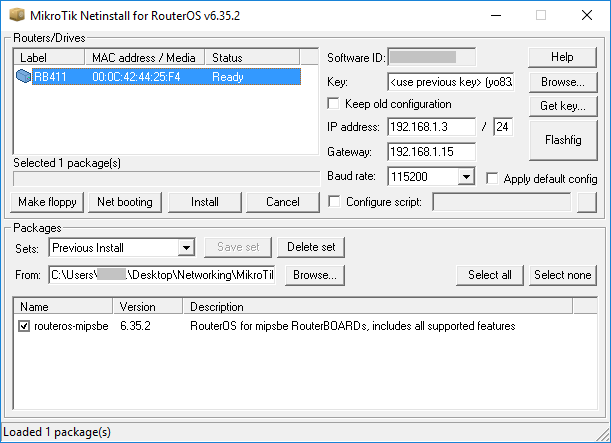

I then boot the device to Ethernet and start up “DHCPServer” on my Windows 10 laptop to offer an IP lease, and start up Netinstall with Netbooting active. Looking at the serial console, the board gets the IP, goes into kernel mode and awaits the installation server to send its offer. THIS is where this go wrong…
The netinstall session finds the RouterBoard, and with everything ready to install, I click on the board and then on Install. The status then changes to “installing” and the Progress Bar changes to “Sending Offer”. This goes on for a few seconds, and then back to “Ready” without installing the package…
I’ve managed to get the Package installed by using the exact same utilities open on any other laptop, and once the RouterBoard received its IP address from the Gateway, to plug the ethernet cable into the other laptop where Netinstall picks up the board, and I can continue installing the packages…
Is there a way that I can find out why this specific laptop won’t install via netinstall?

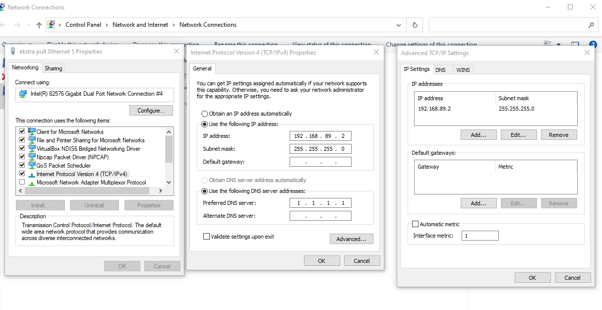

Just wanted to add this in case someone runs into the same issue. To fix my sending offer issue, I had to disconnect the ethernet port going into my docking station which is connected to my laptop via USB-c cable. I forgot that all connections being disconnected (except for the one going to the Mikrotik device) before using NetInstall was a good thing. Worked right after I unplugged the ethernet cable (probably because it was sending the offer down the wrong ethernet port while the cable was connected to the dock).
The long-term solution if you don’t want to disconnect your ethernet cable every time is to:
Head into your network adapter properties
IPv4 Properties (Same place you set a static IP)
Advanced Button
Un-check Automatic Metric
Set the Interface metric to a number (lower number = higher priority / first to respond to internet requests)
Confirm all settings
Tested it myself. Left automatic metric on and tried NetInstall. Sending offer issue remains. Only turned off Automatic metric and set the metric to one. NetInstall works normally with docking station cable still connected.
