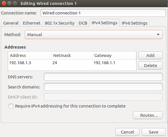

i have set static ip on my laptop ether port and made sure its the same range and subnet on netinstall.

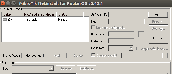

I’ve just downloaded Netinstall v.6.42.1 and works OK. Tried with your IP addresses, everything works fine.
Please, check:
  • All your computer interfaces are disabled, except your wired interface.
  • Configure wine to work like ‘Windows 8’ (this is the configuration I have).

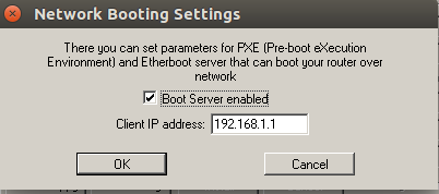

  • After enabling ‘Net booting’ with IP address, close the window
  • Now, power-off your router. Press reset button and keep it pressed. Turn on your router. Wait with reset button pressed… It takes about 30 seconds with RB951

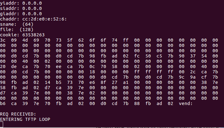

When I read ‘REQ RECEIVED: ENTERING TFTP LOOP’ after than terminal shows ‘port: 43264’ and the router is shown.
REQ RECEIVED:
ENTERING TFTP LOOP
port: 43264
recv bytes: 302

Anker Usb Ether adapter set up as connection 2 with static address added.
