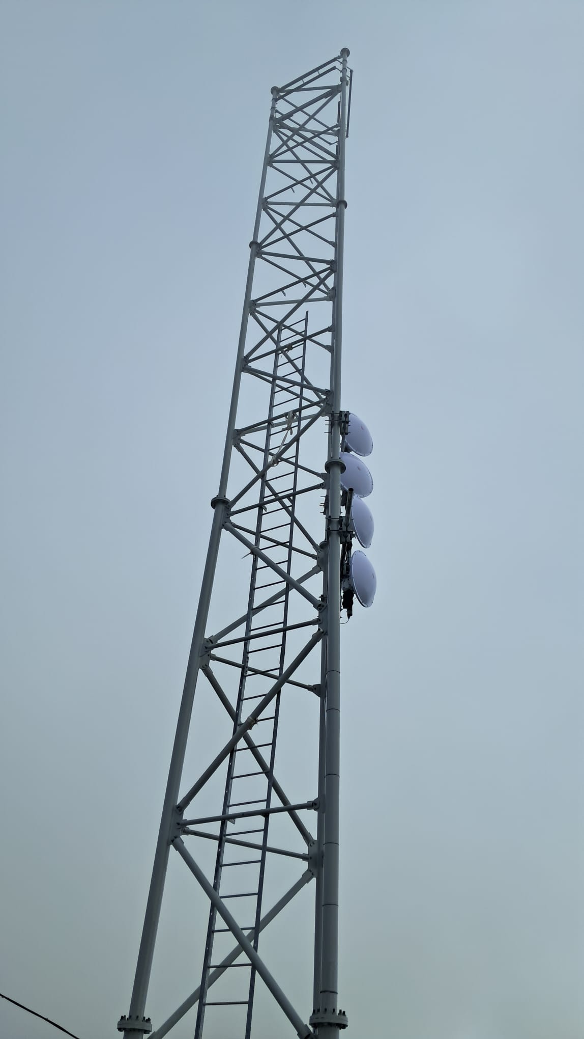

I would like to share our experience with the MikroTik NetMetal ax.

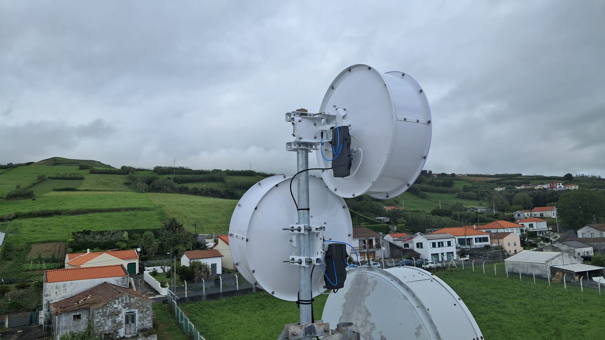

We were hired to deploy multiple point-to-point links ranging from 1 km up to 28 km. We successfully achieved these links using the MikroTik NetMetal ax together with the MikroTik mANT30, performing precise alignment. The performance has been excellent giving the distances, as shown in the photos below.

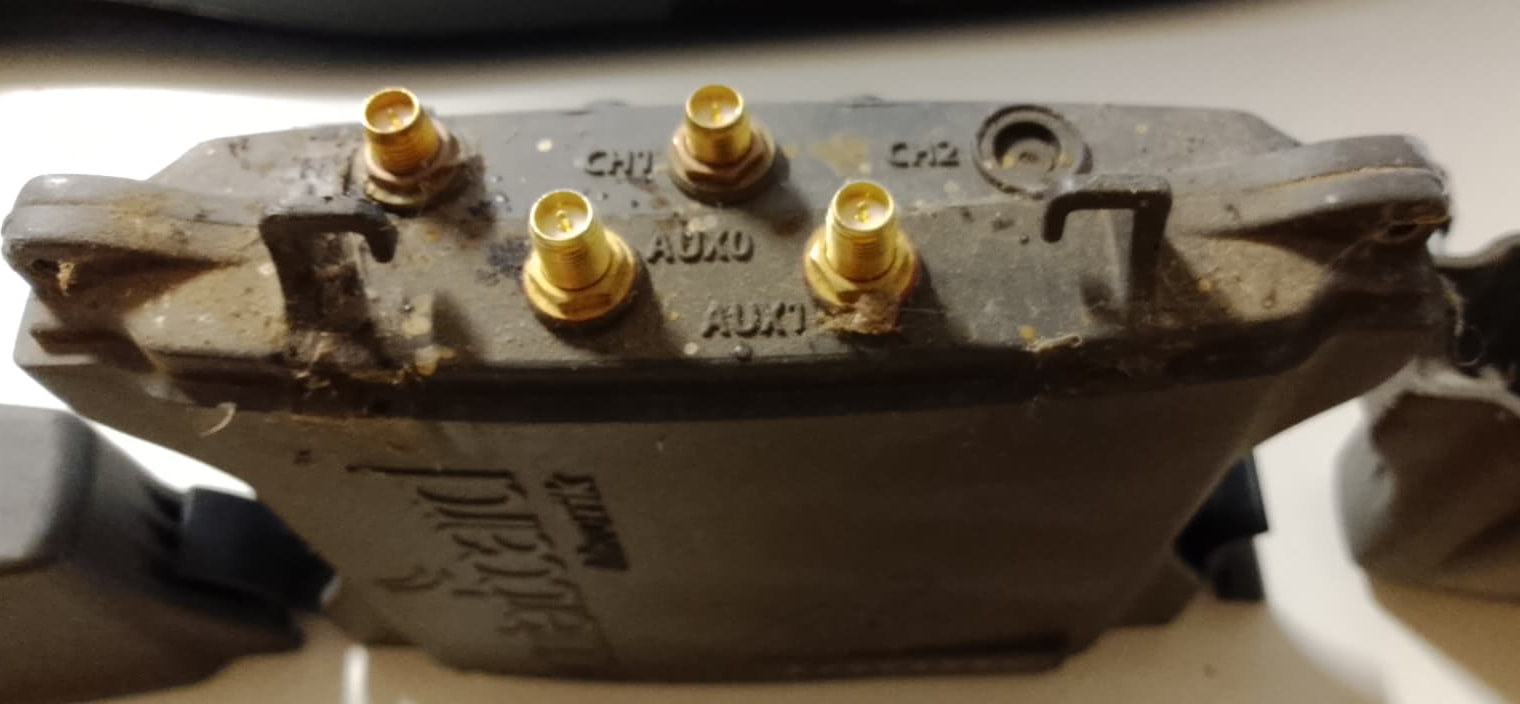

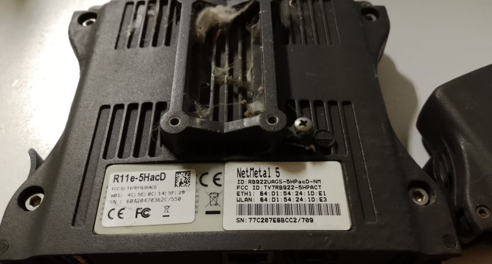

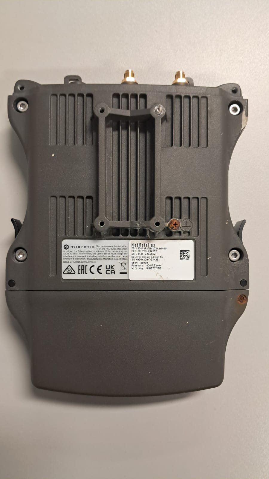

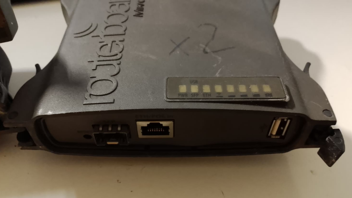

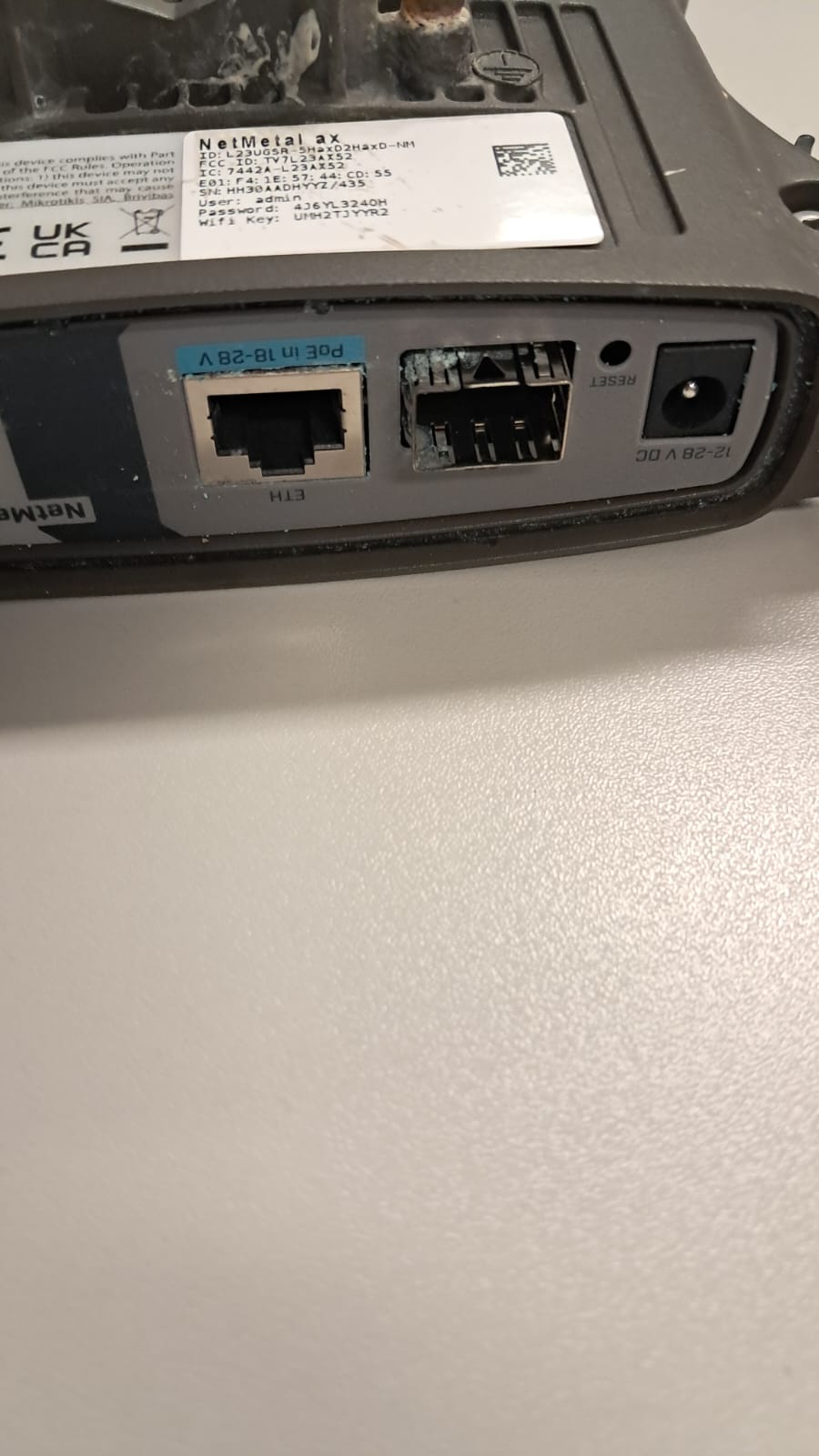

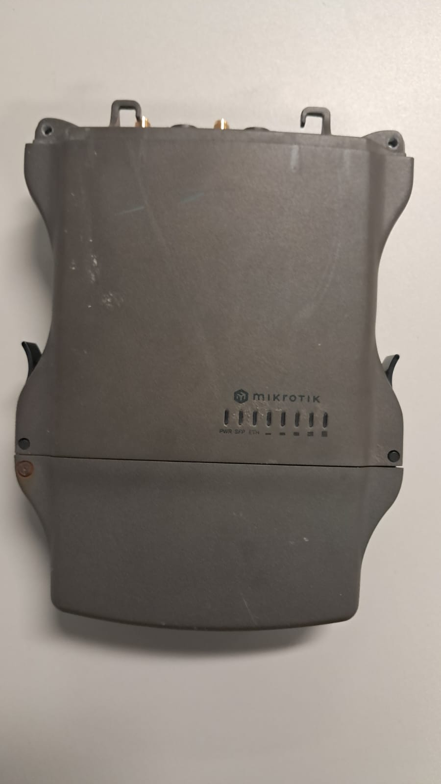

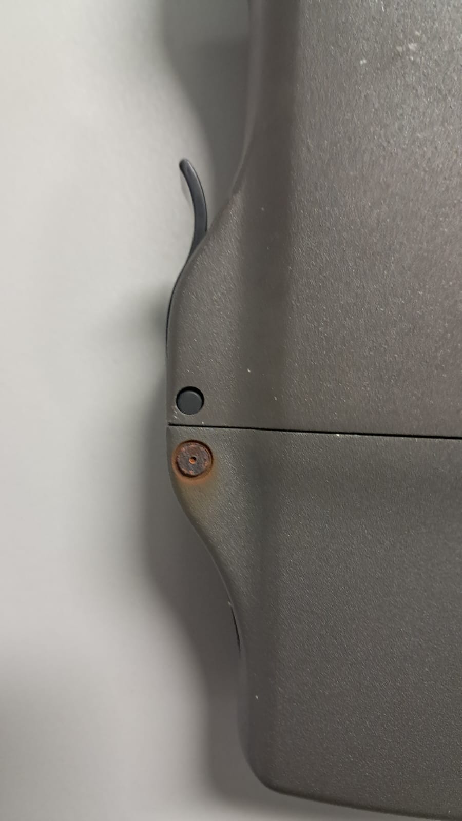

However, after approximately 9 months of operation, we started facing serious issues with corrosion in several units. Some radios are going offline, and upon inspection, we observe visible corrosion on the exterior (for example, on the grounding screw) as well as internal corrosion inside the device.
We are unsure how moisture could have entered the units, as we followed the recommended installation procedure. We used the original rubber sealing ring and made only a small cut to allow the surge protector cable to pass through.
According to official MikroTik support, the devices going offline could be caused by “bad assembly at the installation site.” However, we are struggling to understand how equipment rated with IP66 protection could reach this condition after only 9 months of operation, especially with corrosion visible even on the external screws and near the led indicator.
Because the issue has been classified as improper installation, the units are not covered under warranty. This has resulted in significant replacement costs for us and is making us reconsider whether we should use a different brand for similar installations in the future.
Has anyone else experienced similar corrosion issues with NetMetal ax devices in outdoor deployments? Also, if someone sees something strange in the installation photos above, let me know! We are always learning :slight_smile:
Thanks!
PS: The fotos of the damage device are actually photos of two different devices, one that we had opened, and another that we didn’t touch but externally we can see exactly the same problem

I can see several different issues.

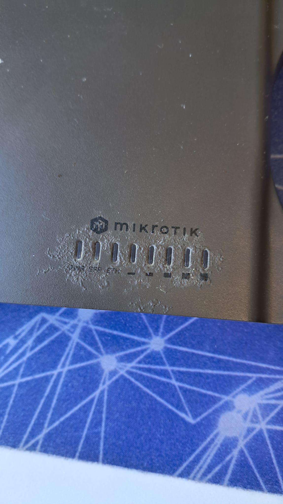

The bubbles in the paint near the leds (top left photo of the 6 set) seems like a defect of the paint (or of the surface below it).
The rusted screws/pins (right top and right bottom of the set of six) are (IMHO) "normal" rust, you can avoid it in most cases putting a little bit of vaseline grease on top of them at installation time.
Both the above should be mostly esthetic issues only.
In the top right picture it seems to me like you also have a broken screw (probably removing the unit from the pole), there as well filling the threaded hole on the aluminum case with a bit of vaseline or silicone grease would be a good idea.
The real issue is condensation/water/humidity inside the device.
From the first picture the cables going to the antennas seem mounted correctly (but cannot say if you used (not a bad idea) some self-fusing tape around the antenna connectors.
The way the bottom cable is isolated when entering the bottom cover is not detailed in the photos, from the first photo the downfacing loop is a little too tight for my tastes, but it is unlikely to have brought water inside the device.
So, what remains is condensation.

I see that same sort of bubbling when corrosion gets under aluminium.
As for the Vaseline I would go for a silicone grease, then you can put it on the rubber o-ring and they shouldn’t get eaten by it and the seal on them will be a heap better than without any grease
Yep, but usually It means that the surface was not properly prepared for painting, or that the paint (or primer if any) did not get proper adhesion.
And yes, silicone grease would be even better than vaseline.
For the corrosion bubbles around the leds, there is no mechanical defect visible. So it must be a fault at factory. And there are several possible reasons for this to happen. In any case I would classify this as a manufacturing defect.
The corrosion on the grounding screw could be galvanic corrosion. The surge protector might also not be completely sealed, exposed perfectly to rain, especially against humidity or condensation. Moisture could travel along the network cable and enter the housing this way.
