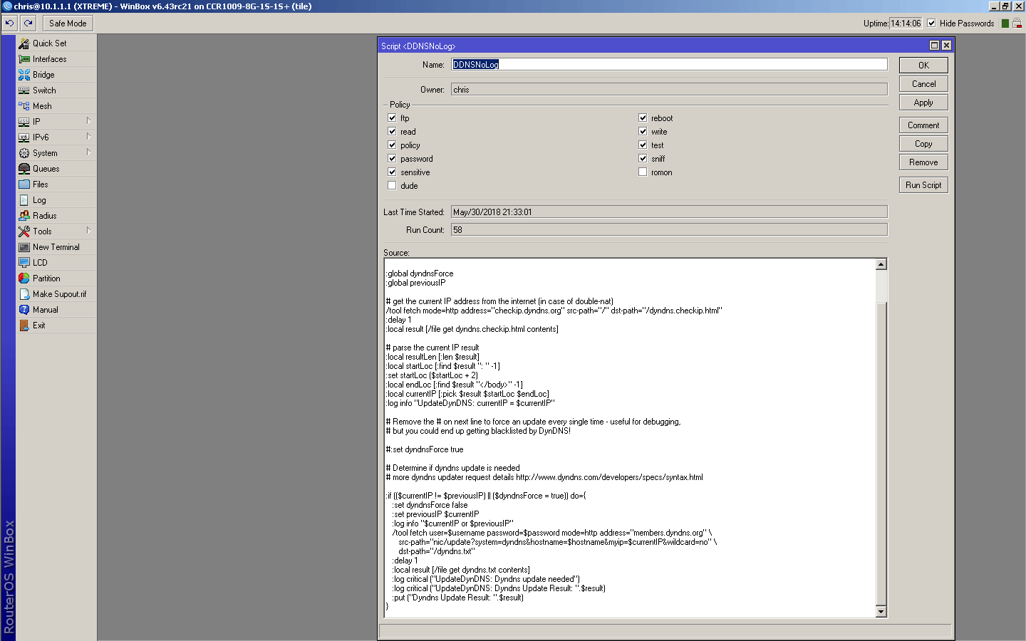

I have fully tested the DynDNS script executing it from winbox on RouterOS 6.43RC21 on a CCR1009-8G-1S-1S+ and it works. It updates DynDNS.. I scrambled my MAC which causes a cable modem to provide a new IP I then ran the script and reloaded DynDNS and watched it update in near real time. I did this 3 times to be sure. So on this version of OS on this hardware I can confirm it does work.
I had all the permissions checked.
This script is slightly different as it does less logging.
Go delete any related files before running it. Run it twice to make sure.
# Set needed variables
:local username "your username"
:local password "your password"
:local hostname "your host name"
:global dyndnsForce
:global previousIP
# get the current IP address from the internet (in case of double-nat)
/tool fetch mode=http address="checkip.dyndns.org" src-path="/" dst-path="/dyndns.checkip.html"
:delay 1
:local result [/file get dyndns.checkip.html contents]
# parse the current IP result
:local resultLen [:len $result]
:local startLoc [:find $result ": " -1]
:set startLoc ($startLoc + 2)
:local endLoc [:find $result "</body>" -1]
:local currentIP [:pick $result $startLoc $endLoc]
:log info "UpdateDynDNS: currentIP = $currentIP"
# Remove the # on next line to force an update every single time - useful for debugging,
# but you could end up getting blacklisted by DynDNS!
#:set dyndnsForce true
# Determine if dyndns update is needed
# more dyndns updater request details http://www.dyndns.com/developers/specs/syntax.html
:if (($currentIP != $previousIP) || ($dyndnsForce = true)) do={
   :set dyndnsForce false
   :set previousIP $currentIP
   :log info "$currentIP or $previousIP"
   /tool fetch user=$username password=$password mode=http address="members.dyndns.org" \
      src-path="nic/update?system=dyndns&hostname=$hostname&myip=$currentIP&wildcard=no" \
      dst-path="/dyndns.txt"
   :delay 1
   :local result [/file get dyndns.txt contents]
   :log critical ("UpdateDynDNS: Dyndns update needed")
   :log critical ("UpdateDynDNS: Dyndns Update Result: ".$result)
   :put ("Dyndns Update Result: ".$result)
If your script does not work, then it is because to one or multiple lines that can not be executed. You can debug your script and find out which line was the first that did not allow for the script to run properly. This is the command that we are looking for.
