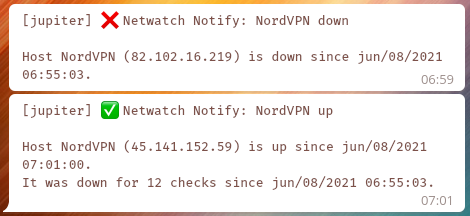

You may be interested in my script “Notify on host up and down”.
It gives some extra functionality (like simple state machine and dependencies) and sends nicely formatted notifications via e-mail, telegram and matrix.
