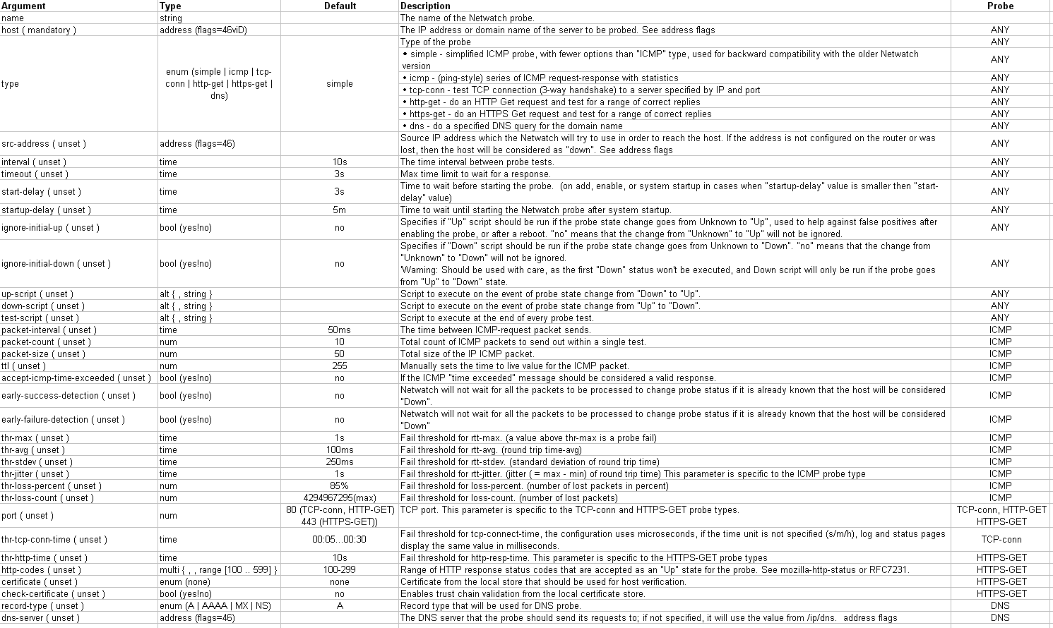

It is much better, though I hate this approach.
If you publish a table, add a column for default and one for probe, things will be much easier to read. (but this is probably just me)
A small thing, but make up your mind, you call the same thing once HTTP/S-GET and once HTTPS-GET.
I insist on the fact that if you list thr- in this order:
Column 1 Column 2
1 thr-max ( unset )
2 thr-avg ( unset )
3 thr-stdev ( unset )
4 thr-jitter ( unset )
5 thr-loss-percent ( unset )

Column 1 Column 2 Column 3 Column 4
1 thr-max ( unset ) 1 loss-count
2 thr-avg ( unset ) 2 loss-percent
3 thr-stdev ( unset ) 3 rtt-avg
4 thr-jitter ( unset ) 4 rtt-min
5 thr-loss-percent ( unset ) 5 rtt-max
6 thr-loss-count ( unset ) 6 rtt-jitter
7 rtt-stdev
this proposed way is much more readable, logic and linear:
4 rtt-min
1 thr-max ( unset ) 5 rtt-max
2 thr-avg ( unset ) 3 rtt-avg
3 thr-stdev ( unset ) 7 rtt-stdev
4 thr-jitter ( unset ) 6 rtt-jitter
5 thr-loss-percent ( unset ) 2 loss-percent
6 thr-loss-count ( unset ) 1 loss-count
but that is just like my opinion, man :slightly_smiling_face:.
Finally, if you write here:
Column 1 Column 2
bool (boolean) values can be true or false.
You (IMHO) CANNOT (almost everywhere else) write that a bool type has a default of "no" (and thus the "other" value is "yes").
bool is 1/0 or true/false, yes/no is something else

Then this (example on the netwatch page we are discussing):
ignore-initial-up ( unset ) bool Specifies if Up script should be run if the probe state change goes from Unknown to Up, used to help against false positives after enabling the probe, or after a reboot. no means that the change from Unknown to Up will not be ignored. (default value: no)
says that the variable is of type bool and that it has a default setting of no (and conversely its opposite is yes), but the definition of bool is that values are either true or false.
