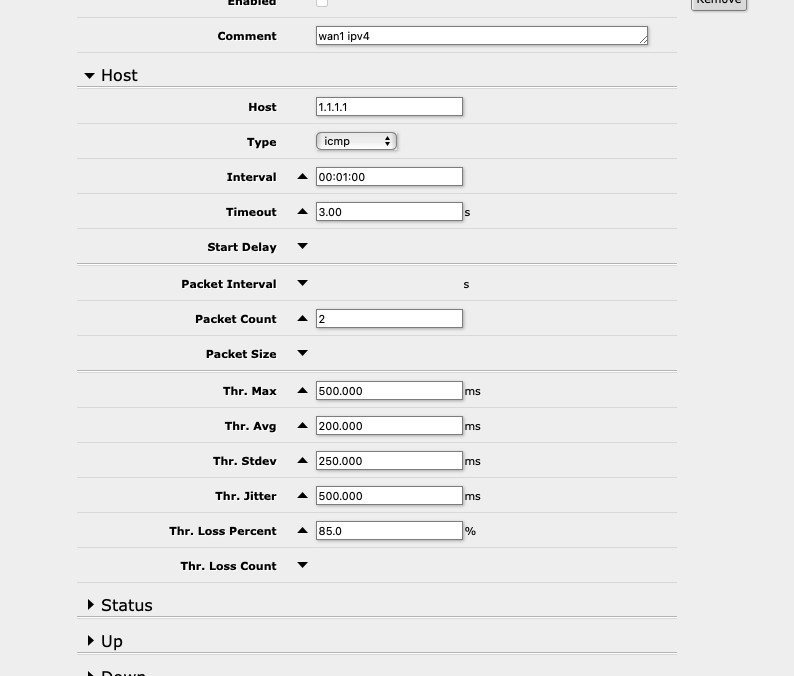

with more recent V7 you can now at least use src-address now for netwatch, i have yet to lab this as well just like you I also use recursive routing for WAN monitoring
sorry, but I do not see src-address for netwatch … (ROS 7.10.2)
ok, I saw, it is only on 7.11 (beta).
But even with src-address param, we cannot use multiple ip to check.
If the single defined ip is down, mkt will consider wan interface as down. I prefer to have multiple…
