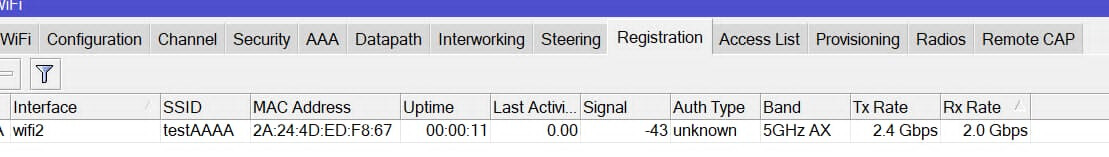

I’ve got a new ax s. Happy to see new chipset. I’m testing wifi capabilities, and results are not good enough. Wifi client is connecting with 2.4gb/2.0gb tx/rx rates, and max speed is about 500 Mbit/s
Configuration is simple. Any suggestions?

How do you test ?
Wifi connected to hap ax s and then where to ? How ?
External speed test server ? Then it might be normal.
Test results for hap AX S as router are about 500Mbps.
Try to test using internal iperf3 server connected to one of the LAN ether ports. See what speed you get then.
I know there's no HW offload on eth1, so I'm using WAN on eth2. Cable speeds are up to 1Gbps, but Wi-Fi still maxes out at 500Mbps.
Wifi test on pixel 8 pro, ookla speedtest app
Since you have 1 port as WAN, it's not part of your bridge (I would think) so it's not HW offloaded.
If you do that same Ookla speed test from a cabled computer, to you get 1Gb ? Or also 500Mbps ?
see cfg above, its simple ap bridge
Just to be 100% sure ...
Cabled computer, connected to one of the LAN ports of hAP AX S, same speed test. What do you get ?
up to 1GB/s
