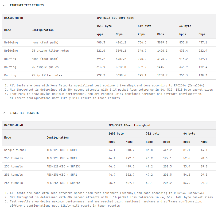

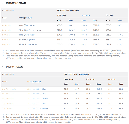

And IPsec test results are yet to be seen

The IPsec numbers were available yesterday, but they have now removed all the benchmark results. You can still see them in the internet archive.
About 10% lower than the hAP ax³ numbers.

Numbers (if correct) are not much impressive tho, AX3 did the same (or better)

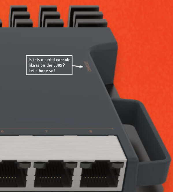

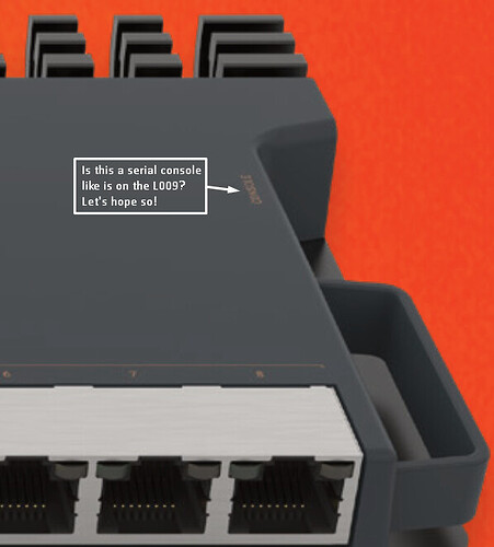

The specs don't mention it, but the picture hints that there may be a serial console like the L009 has.
