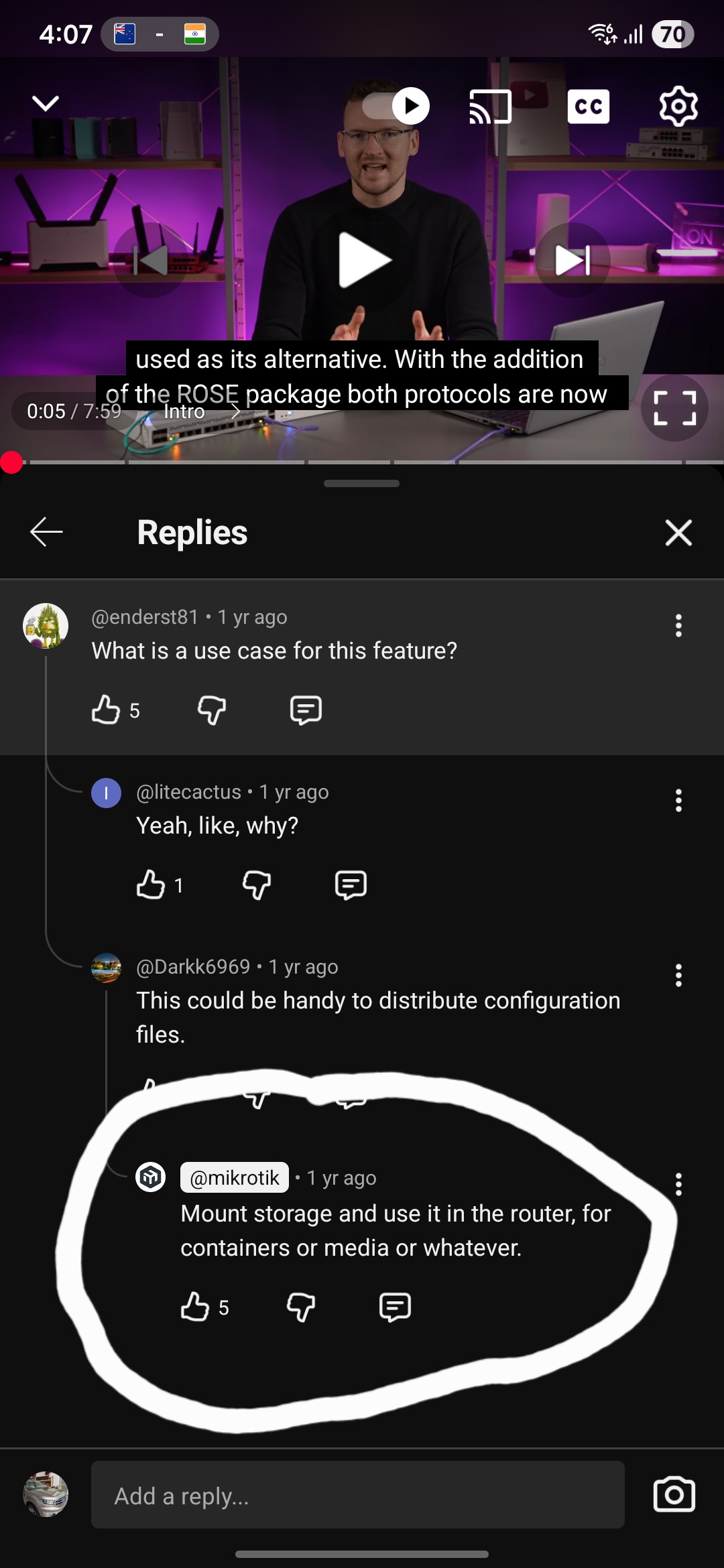

Will try this, but i read that container storage can be in nfs mount, so expected to support in /app section also.

I got this idea after seeing mikrotik comment in YouTube.
