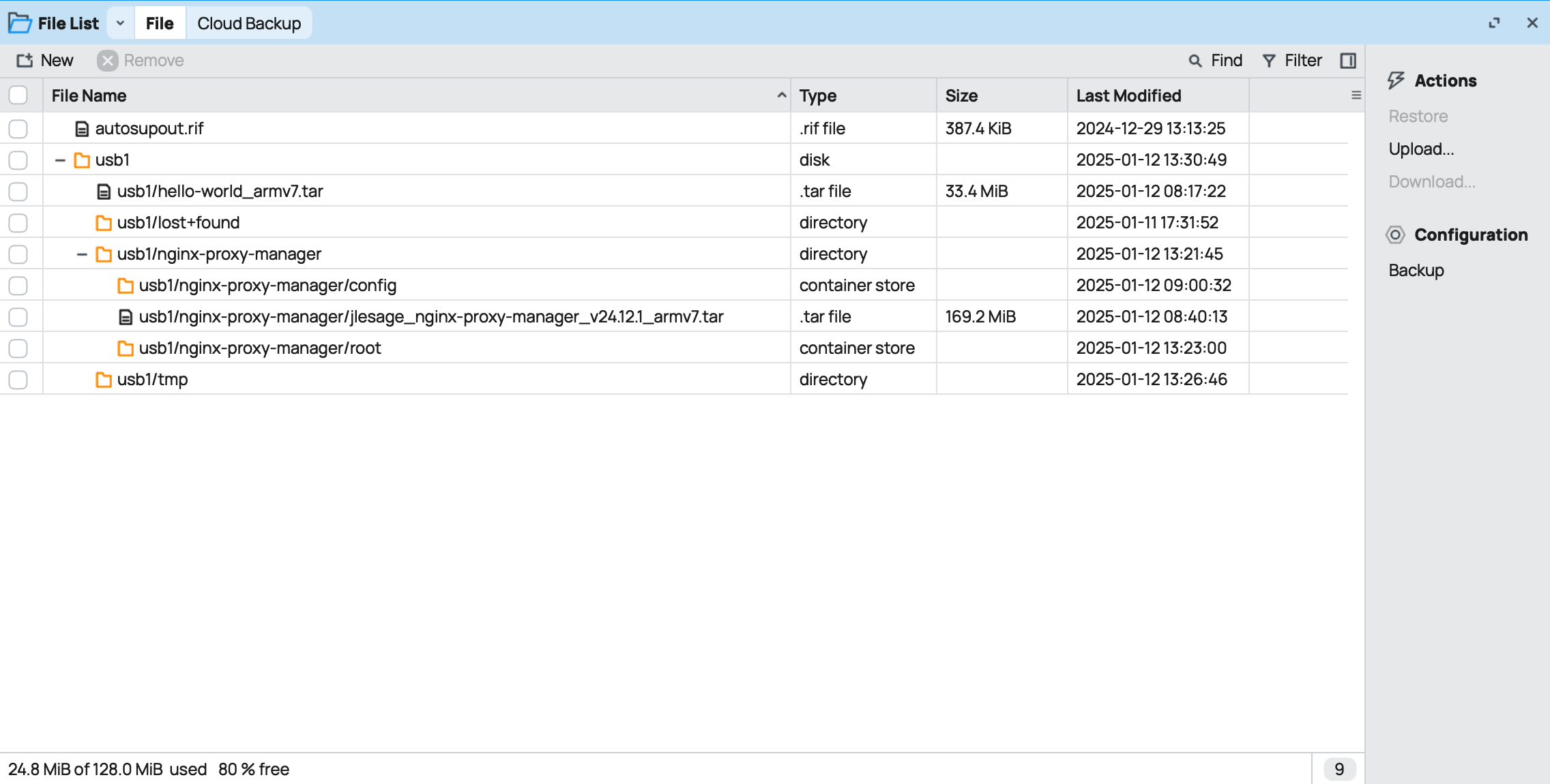

  • I prepared a USB stick (see attachment ‘usb.png’)

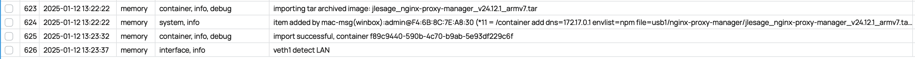

  • The container continuous to extract the image successfully (see attachment ‘logs.png’)
  • When I hit the “Start” action button, the status of the container’s status changes to “started”, a log line “veth1 detect LAN” appears and the container’s status changes back to “stopped”.
  • Memory is Free/Total: 305 MiB/512 MiB, USB stick is 8GB nearly empty, internal storage is Free/Total 24 MiB/128 MiB.
