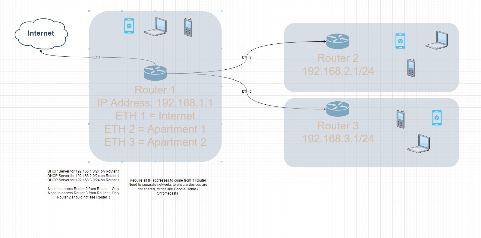

Hi there, I have been searching for answers and ways to solve my problem, but with no luck.
My problem statement is as follows:
I want to separate my networks but still want to be able to access all of my routers.
Also, I would like to limit my ethernet ports, for both upload and download, and currently, this is my biggest problem. Queues don’t work because of the bridge mode.
So from research, I understand that I need to remove the ethernet ports from the bridge, and that way I can limit the bandwidth on those ports.
This is how my setup looks:
Main router: 192.168.1.1. It has internet on port 1.
Port 2 goes to another router
Port 3 goes to another router
Port 4 goes to another router.
Currently, they are all on the same network, but I would like to separate them to their own.
i.e
Port 2 goes to 192.168.2.1/24
Port 3 goes to 192.168.3.1/24
Port 4 goes to 192.168.4.1/24
I still want my main router to issue the IP’s for each network as the DHCP will be configured on the main router for all.
I would like to still be able to access each network from the main router. I believe this can be done via firewall rules, but struggled to get that working.
Steps tried:
  1. Configure router 2 to address 192.168.2.5, Gateway 192.168.2.1
  2. Remove Port 2 from bridge in Main router
  3. Routes are automatically created, but then I cannot access resources on 192.168.2.1/24 and they cannot reach internet.
Any advice would be appreciate
Kind regards
Jannie

Here is a diagram of what I am trying to solve.
We have shared devices and I do not want others to control things like a Chromecast for example.
However, I would like to manage all DHCP servers from one router.
Hope this helps.
Thanks guys
Hah, I would use vlans and basically have vlan20 (apt2) and vlan30 (apt3) only go to the internet.
I would also not allow myself as admin access to vlan20 and 30 to respect privacy.
Your diagram and words are in contradiction.
If you mean dhcp server on your admin router, do you mean all single user/device IPs on the entire network
OR
do you mean control the IP address of Router2 and Router3 ( one router1s LAN, also equivalent to the WANIP of router2 and 3).
If you want to control DHCP on all subnets, then you dont need Router2 and Router3, you simply need to turn those devices into Switch/APs etc.
What devices are these routers??
Hi anav
Thank you for replying.
Regarding the DHCP question, I would like all devices to obtain an IP from one router, doesn’t matter the subnet.
They are all Mikrotik. The one is hAP-AC and the other hAP
Easily accomplished.
