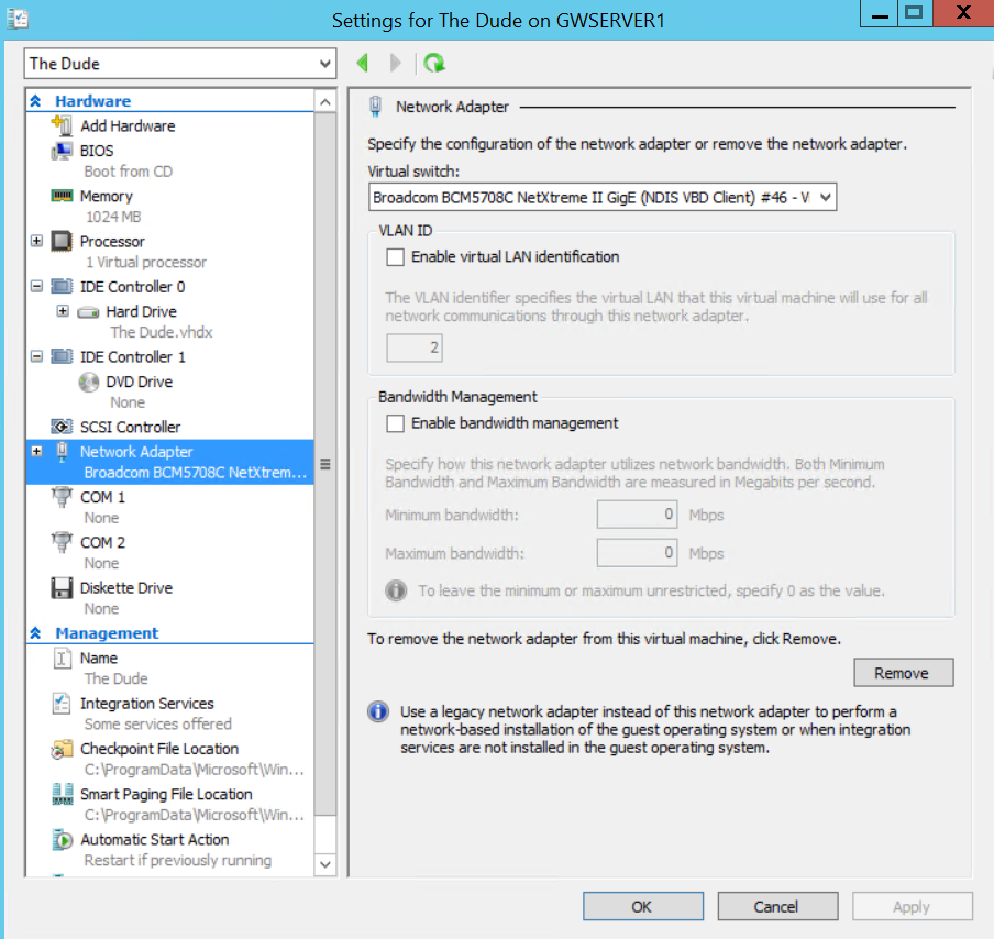

Yes I know this, as I have three other linux VM’s running now. Two Ubuntu 16.04 and one Ubuntu 14.04. I have assigned a NIC to it in the Hyper-V settings. Once the NIC has been added to the VM in Hyper-V, I would think RouterOS would be able to see it, right?

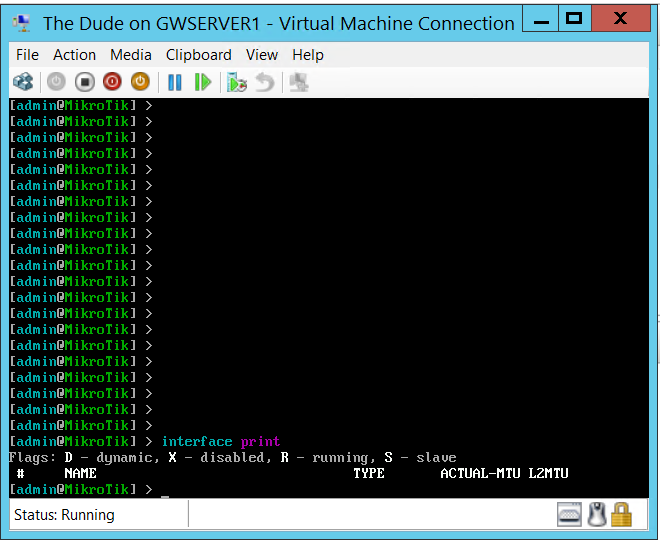

Here’s my interface print so you can see none listed
Here is the Hyper-V settings

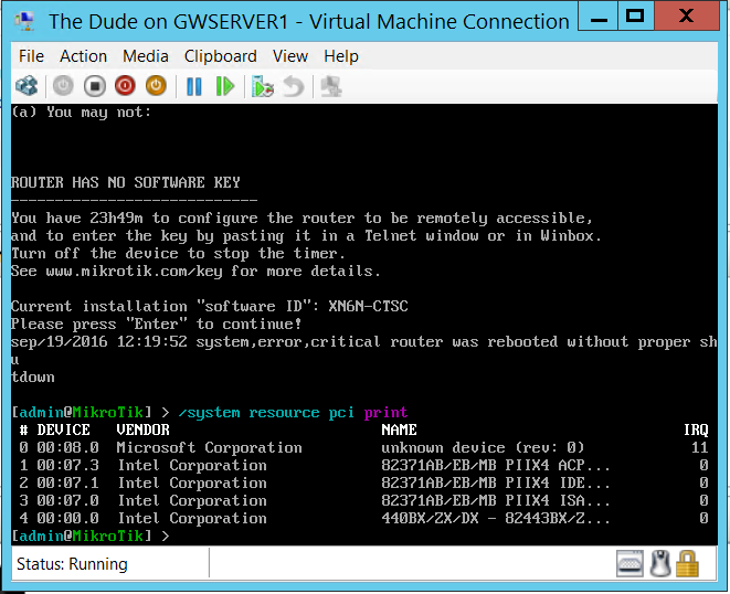

what you see in /system resource pci print detail?
do you see BCM device there?
No BCM device, here’s a screenshot.
So I figured it out… In installing the OS, i downloaded the wrong file. I downloaded the regular RouterOS, not the CHR. After installing RouterOS CHR, I have an interface!
